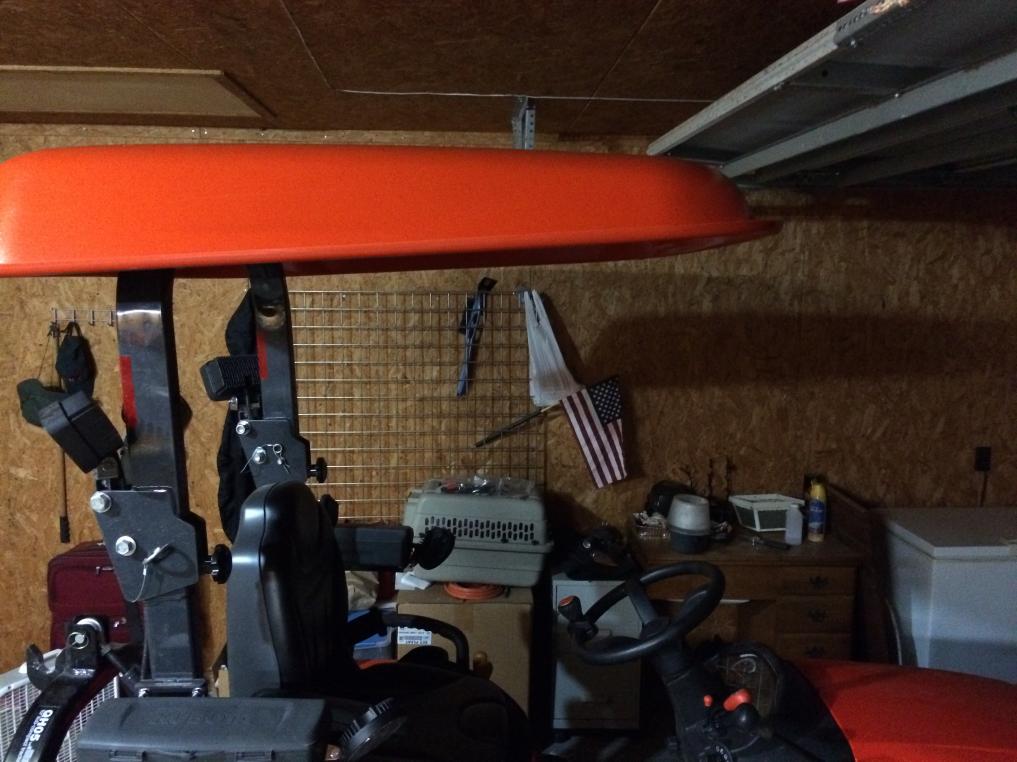

The ROPS is to tall, I cut 10" off mine and now it looks right with the canopy. I'm 6' 6" tall and it still provides safety and it fits in my garage.
https://www.youtube.com/channel/UCsF0NLJSvjdzEnX5XGi7C9A/videos
Unless your an engineer and or chassis cage builder...... I'ld suggest folk not second guess the professional who design ROPs.
Example; that 10" you cut off may well be forced upon the designer by a lawyer afraid of tall people....... ORRR..... then again more likely.... it is NOT be to keep the ROP high enough to clear even a tall persons head... but instead to keep a flop to the side or tip over backward; to go no further, thus never becoming a roll in the first place.
Not an engineer but save there careers monthly and have built many cages from the county jail to a diesel dragster.
I also noticed on previous BX's that the ROPS were smaller.

Just FYI, the reason the ROPS is so tall is so if the tractor is completely upside down, with the ground making a line from the hood of the tractor to the ROPS, the ground would still clear a tall person's head.
If you cut it shorter and rolled the tractor completely upside down, you would probably bash your head on the ground.
The way you would check this is take a long board and rest it on top of the ROPS and the front of the tractor. If your head hits the board when your in the seat, your head would hit the ground when your upside down.
The other important thing to consider, is by modifying the tractor safety features, if you ever get hurt you would loose all chances of getting any money from the manufacturer.
So feel free to modify your own equipment, but others please be aware the ROPS is designed the way it is for a good reason.
