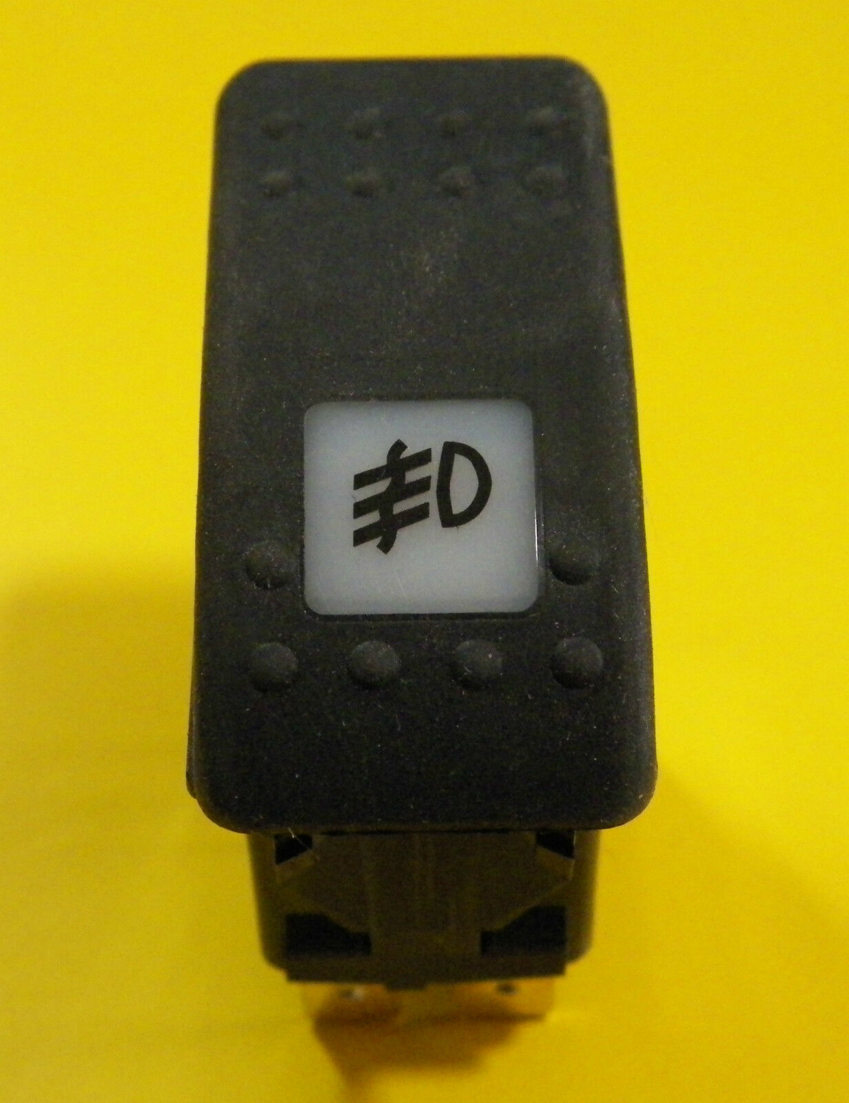

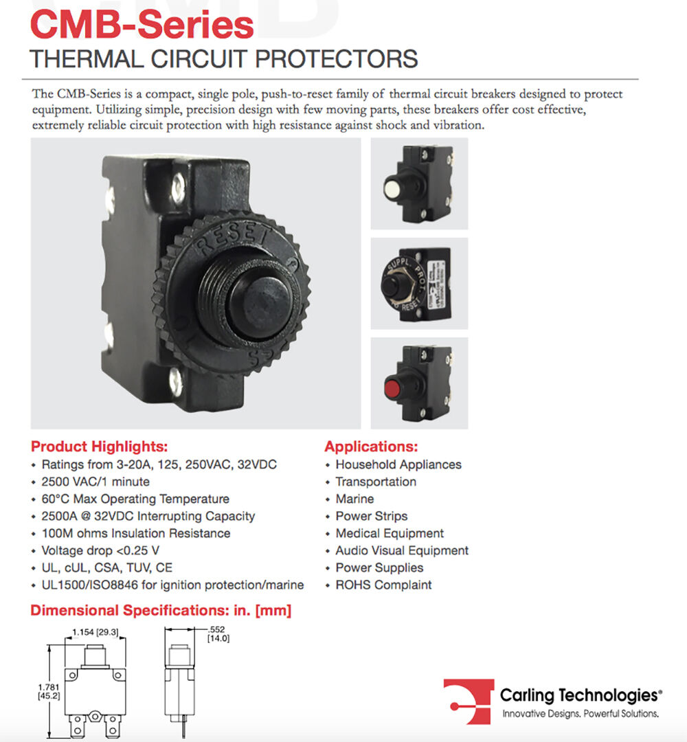

I would stay away from the Kubota 3rd function for only one reason. The button switch that they use for turning the power on and off is extremely fragile and expensive. I have a cab on my BX23S and at the top of the windshield are cutouts for rectangular switches. When they install the windshield wiper and the front LED lights, they will bring a power wire up to the trough that is above the windshield, and you can wire your grapple into that power wire. It is fused individually with circuit breakers. The switches and miniature circuit breakers are manufactured by Carling Technologies and can be found reasonably priced on eBay if you don't care what the legend on the switch cover is. These are used in the marine industry and are very durable.
PS.. I forgot to mention that when you purchase the Carling Switches, go to their website and find the wiring diagram for the number of tabs on the back of the switch. I didn't do this with one of the switches that I installed and promptly blew out the main fuse. It took me over an hour to locate the fuse because it was located behind the battery where it wasn't readily seen.

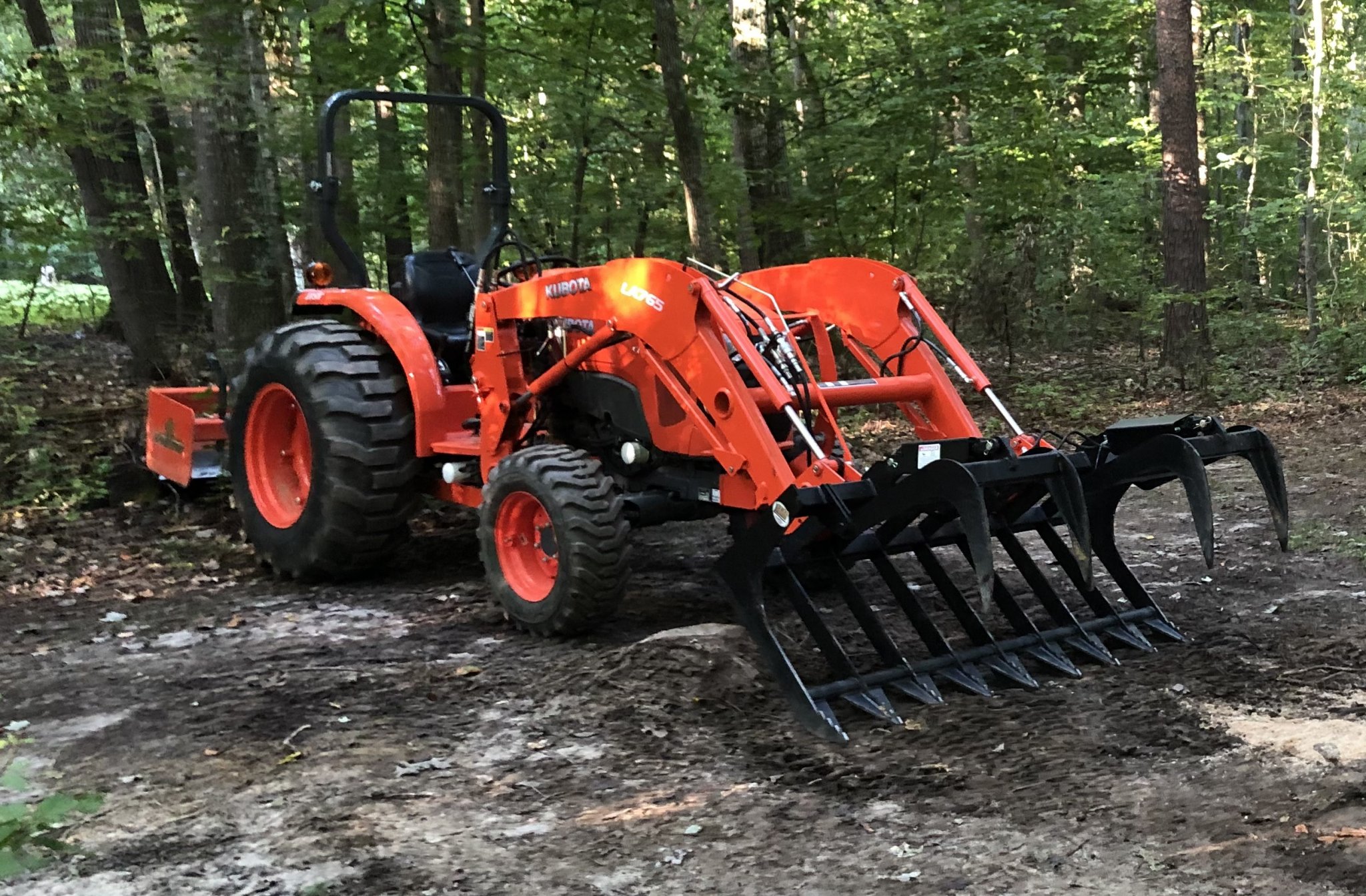

Watched many videos and read many forum posts with mixed feelings. In December I ordered the EA 60" Wicked Root Rake Grapple. https://www.everythingattachments.com/60-Inch-Wicked-Root-Rake-Grapple-p/eta-60-wrrg.htm
It has about a 5 month lead time, which I can live with in my location. My decision was based on research and not - I mean zero - real life experience. This is a single lid grapple. I didn't want an overly heavy unit hanging off the front of the machine.

If I was in the market today buying a new grapple for my MX I would buy a MTL RG-7 HD Root Grapple in 60" width from MTL Attachments. They are currently in stock and price including shipping is $1,699. I own one of their smaller grapples and think they are amazing value. All piviot points have grease nipples, cylinders have guard covers and weight is average at 530lbs. You are going to find many grapples that are in the $2,700 - $3,700 range, my opinion is they are not worth the increased cost.
If you are really into ground engagement / stump removal I would recommend that you take the money you saved on the grapple I recommended and buy a Titan HD stump bucket, at 500lbs this thing works well on the front of an MX other than it is a long way forward and visability is not great but it sure digs well!
