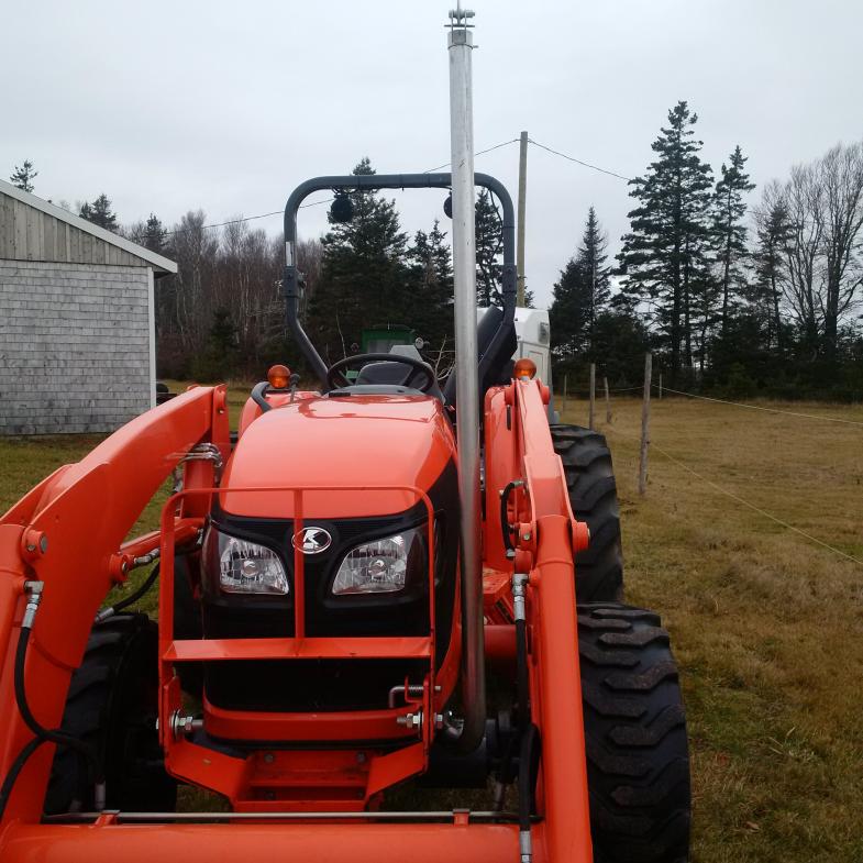

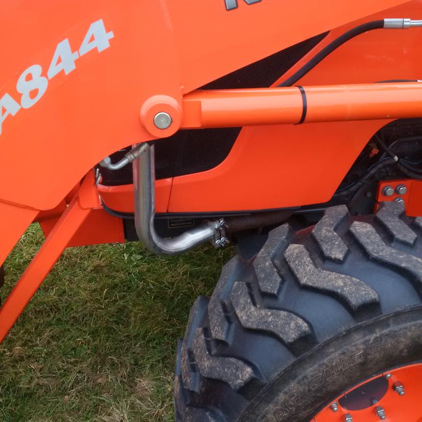

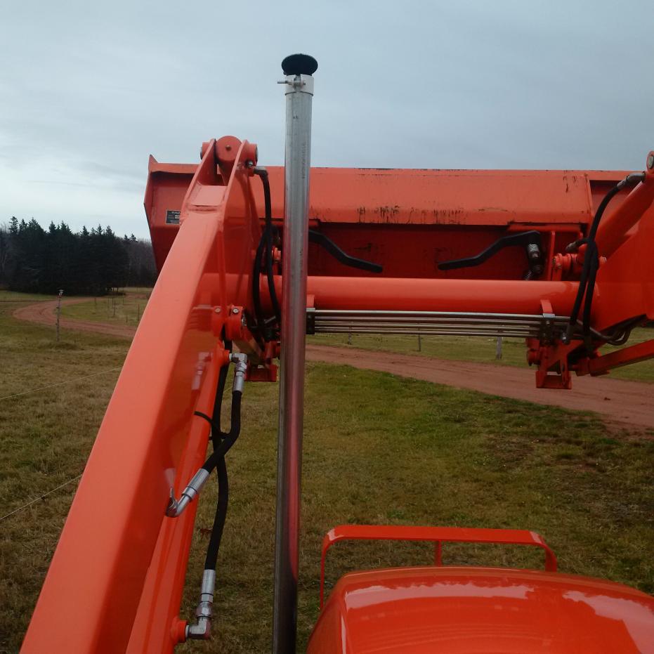

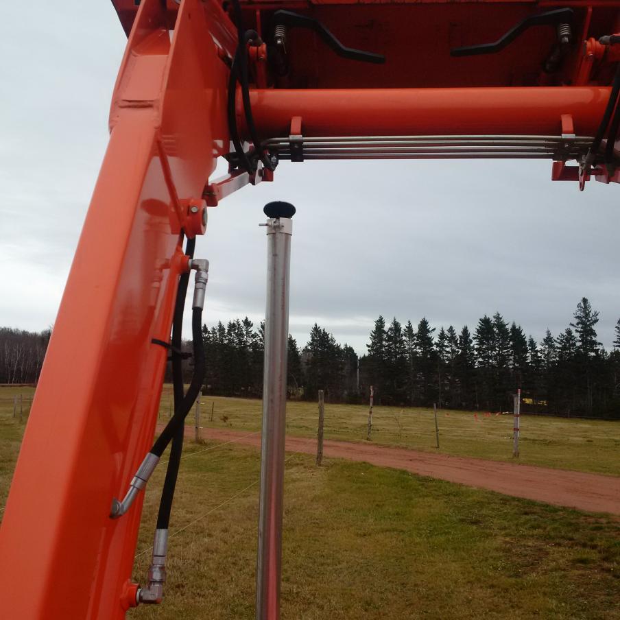

Well I went to my local muffler shop that's been in operation for years. Not one of the chain stores. I got a 6 foot piece of 2" pipe bent approximately 95 degrees, 10 inches from one end and had it flared a bit to go over the 1 78" diameter exhaust. There's not much pipe past the bolt that fastens the exhaust system to the body, but enough to get the pipe on and two clamps. It worked great and it clears the bonnet and loader easily. Cost was $35 cdn. I bought a stack flapper at the Kubota dealer for $12. So the whole job costs under $50. A vast improvement. Thanks for all the input. Keith

Here's what it looks like. I'm pretty satisfied with the improvement. I think it's important to put the two clamps right up against one another. There's not much pipe there but there's a welded fastening point right around 4 inches from the end, so it's pretty solid. The top of the pipe clears the hood and the loader by 2 or 3 inches.
