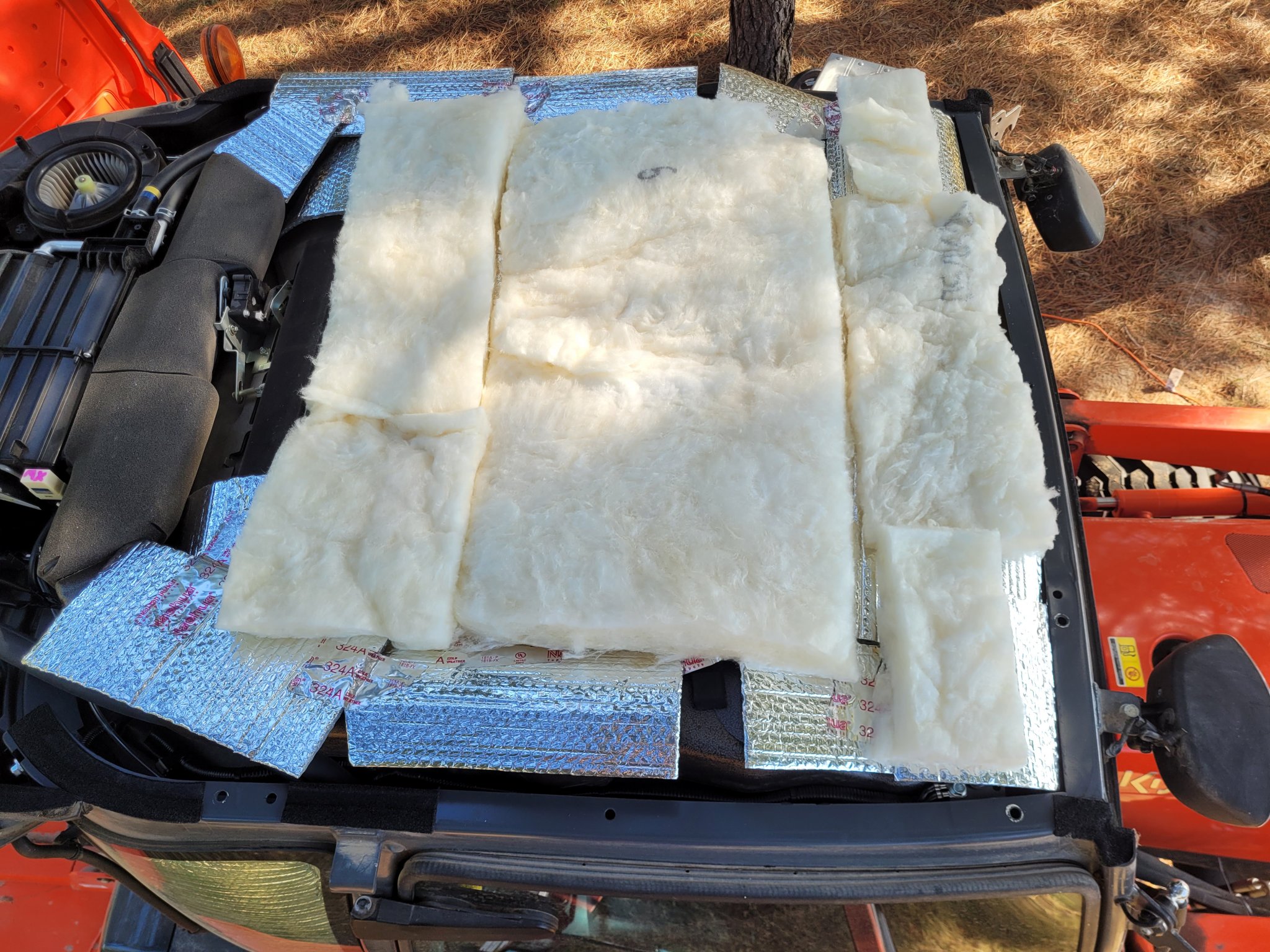

troverman, I decided this morning to jump on the roof before it got to hot and insulate it. Just as you said the roof came off easy. There was what looked like a piece of carpet pad right in the center of the cab. After I blew everything out with my compressor my wife helped me and we added a layer of Reflectex and then a 2" layer of batt insulation. Made sure and covered the duct work as well. From start to finish it took right at one hour.
It was 96* when we finished so I took it out and did some mowing in the sun and I actually had to lower the fan speed one notch. Use to be after 5 minutes out in the sun at these temps my headliner would be warm but not after adding the insulation. I think it made a big difference on mine. I also noticed it seemed a little quieter in the cab. I may add some Dynamat under the seat area at some point. Thanks again for the tip on getting the roof off. Here are a couple of pictures before we put the roof back on.

@Hunter1157 that's great. I will probably do the same when I get a chance. I really think trying to increase the insulation on the floor or under-floor area of the cab would greatly help as well. There's a lot of radiant heat coming up through, and this would likely have a greater impact on reducing noise as well.
