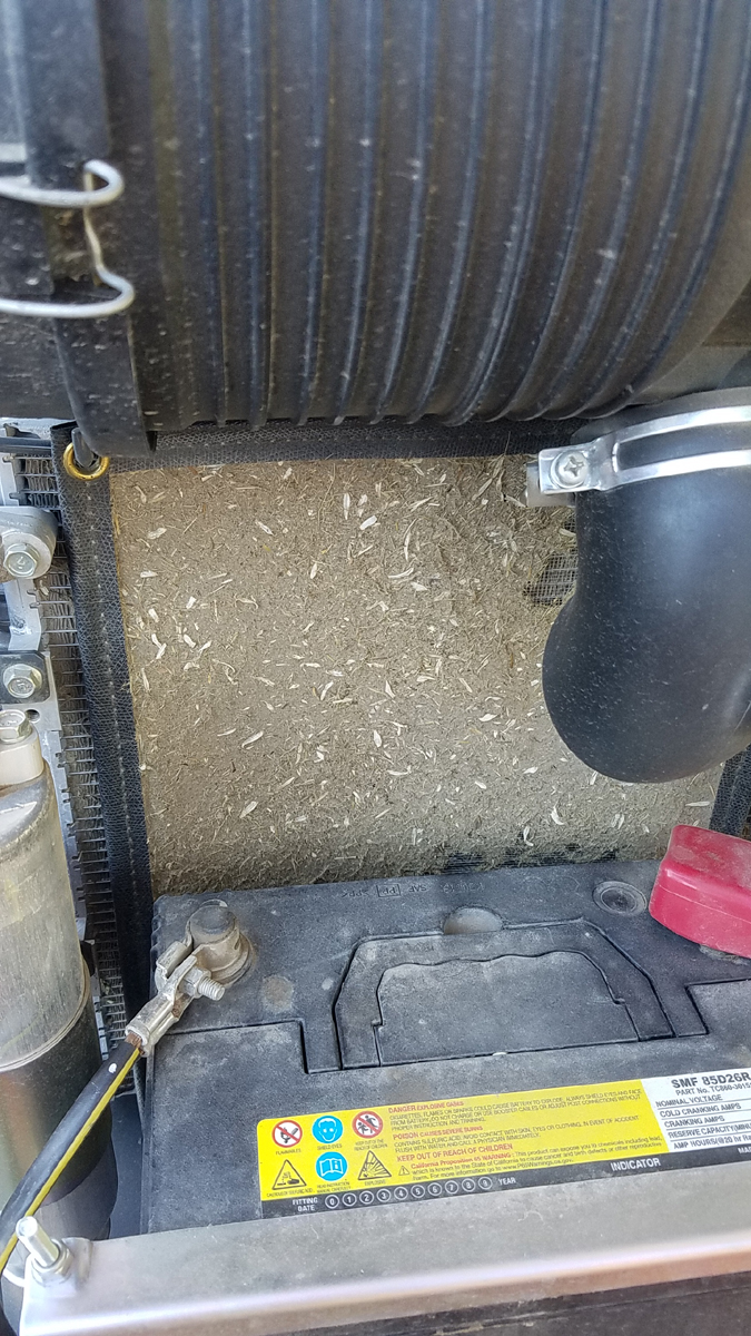

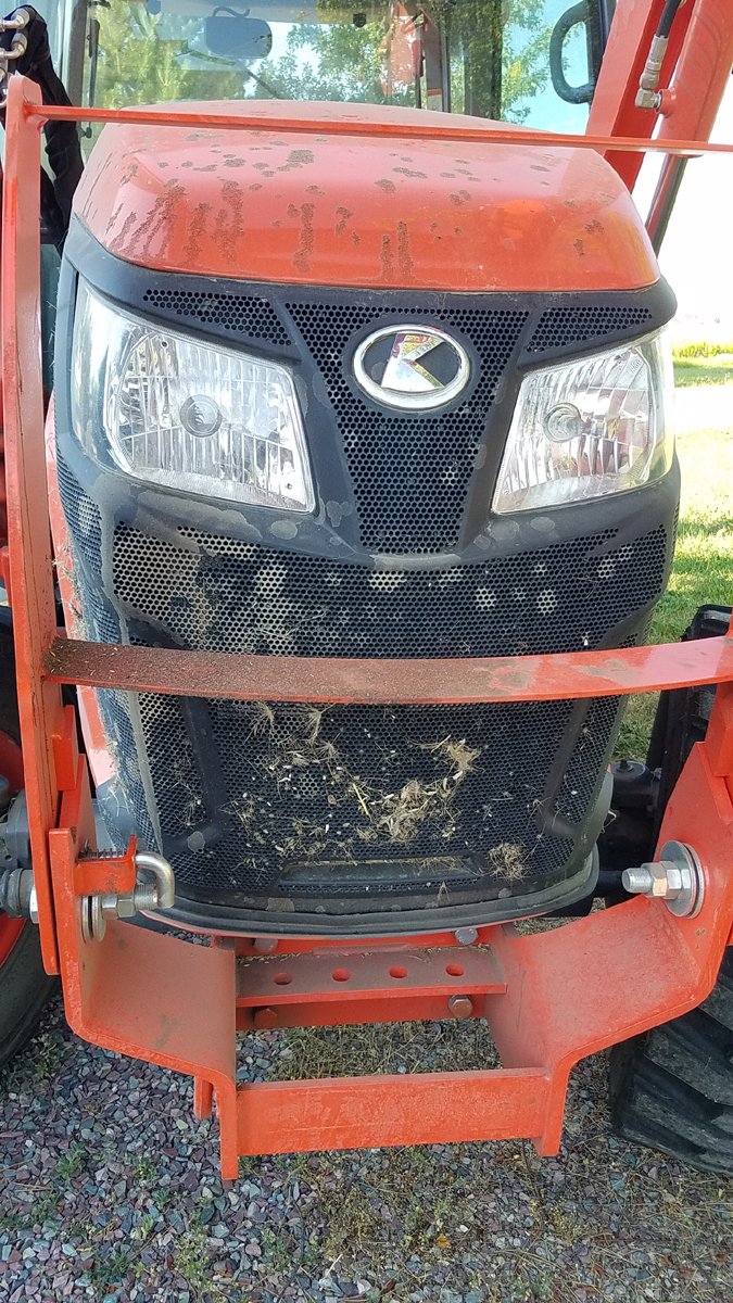

Last night after cutting for close to five hours I could feel the temperature in the cab increasing. The temperature gauge didn't show any significant increase and since it was late I parked the tractor. This morning I raised the hood. The condenser screen, and to a lesser extent the radiator screen, were covered with all manner of grass and weeds. A minute with an Echo leaf blower got everything cleaned up.

this is my experience as well while brush cutting. But as a cab-less savage, I only need to monitor engine temp. I always bring a hose, the water version of radiator genie and a leaf blower if I bring the machine off property to brush cut.
If only there was a screen in development that wraps around the exterior grille, maybe attached with magnets, similar to "winter covers" that wrap over the grille. ;)

I have a similar system for my F250 for summer/winter use but haven't used it yet. I bought it on Amazon for $60 or so three or four years ago. It has snaps that need to be drilled and mounted rather than magnets but the idea is the same.
I probably should have bought a more powerful leaf blower than the Echo PB-2520 but it does work and is able to blow off/out most of the dust and vegetation. Certainly enough to get back to effective A/C performance.
I can see why @Hunter1157 has insulated the roof and is thinking about doing the same for the floor of his cab. I was comfortable in 95F weather but there's very little humidity up here so it might not be as critical for me. That said, insulation against heat is insulation against cold, and sound deadening is always appealing.

@mxmci I’m amazed the AC wasn’t totally warm with that buildup. I guess it’s how clean the condenser cores are behind the cheesy screen.
