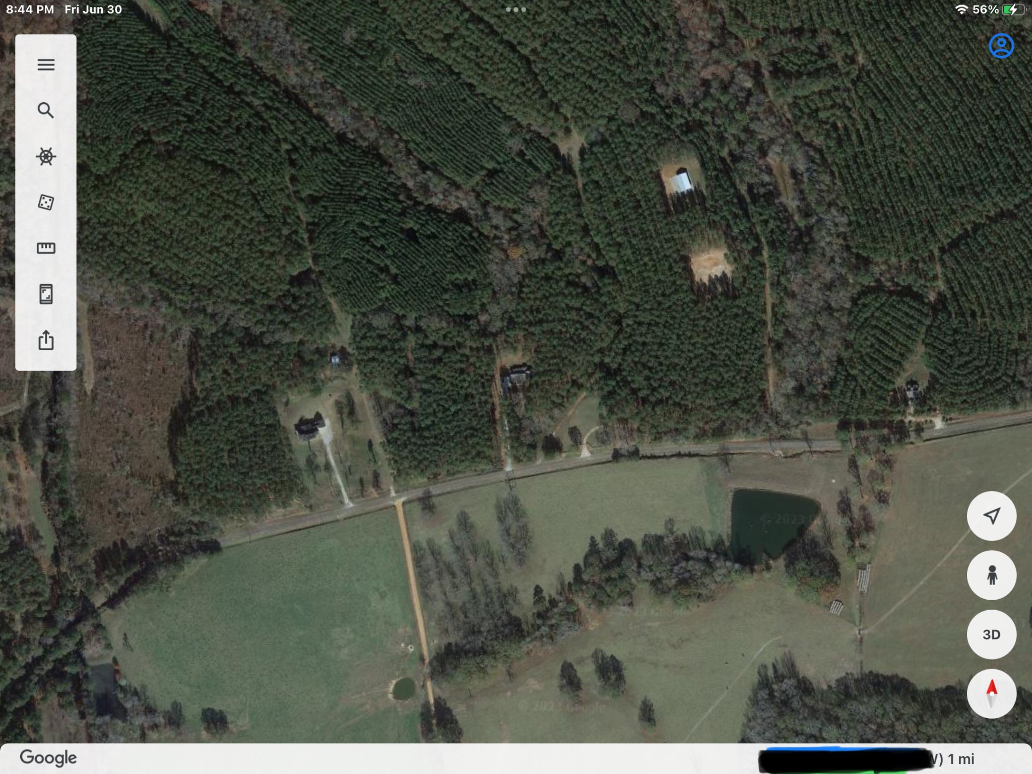

Then again, my childhood home, built by my father, lost every tree at the 6’-8’ level when a tornado went over it. That acreage which was very similar to mine lost every single tree. In a weird way, I’m glad my parents aren’t around to see it. That would have broken the old man.
If we were to experience something similar, clean up will not be fun. Our home is almost dead center in the picture below. Something like you described might be handy. Or, my nephews and daughter can deal with a like-new, unused one when I’m gone. Lol

Looks like you live right in the middle of a bunch of 'Planted Pines'?
A 'grapple' might be useless in those conditions.....so 'skidding' as you allude to is the best option. Give it a shot. Go slow....be careful.
