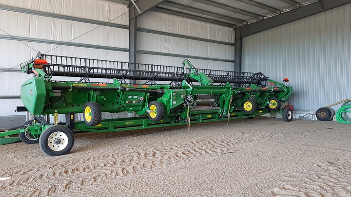

Not nearly as ambitious as the guy over on Yesterdays Tractors. He wants to know if his old 8N has enough grunt to perform yard tug duty on this little heifer. She clocks in at a svelte 40,000 pounds....
Divide that weight by 4 and you will have a more accurate weight. Combines are big but they don’t pick up 20 tons on the front.
10,594
4,475
headers probably around 5,000 from a quik look on the net...
8N can easily pull it
