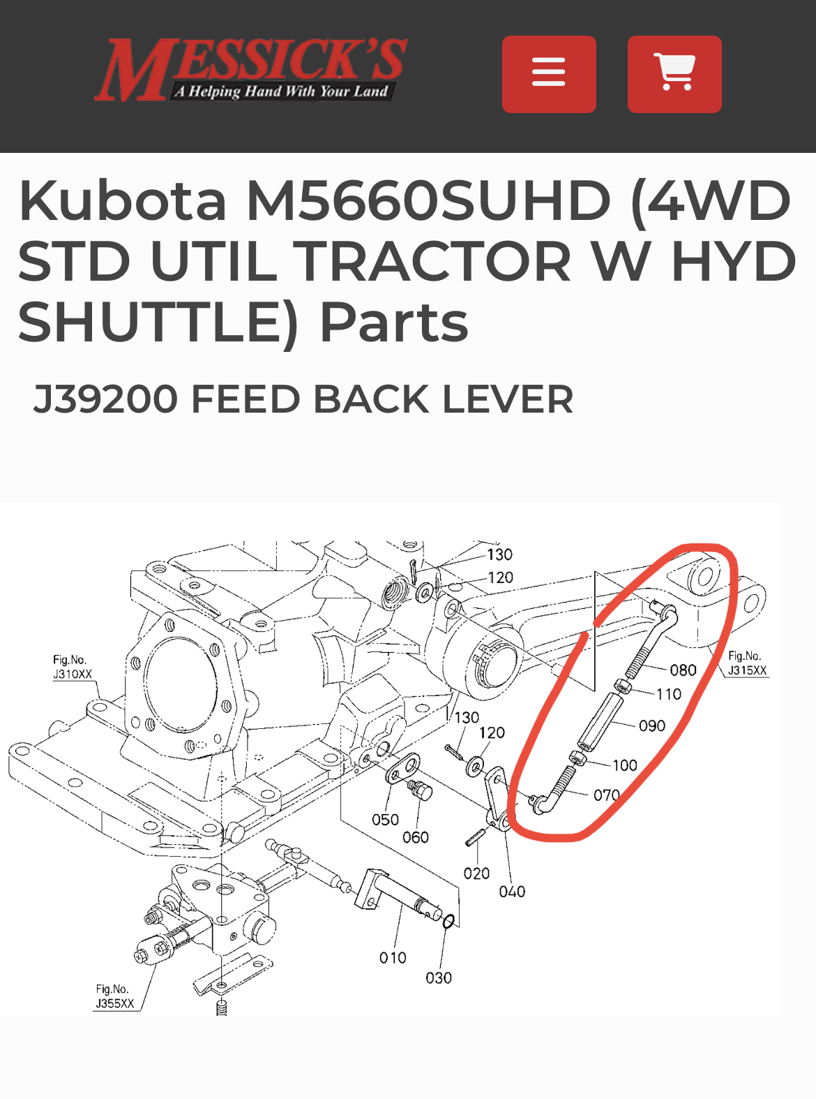

Update: Talked to some techs at the dealership. They said if the lift arms were all the way up and the “back feed lever” wasn’t adjusted correctly that the pump would continue to run against a dead head and the fluid would pass through a relief valve. I went home and raised and lowered the lift arms and I can hear a difference when the arms reach all the way up so I don’t think this is the problem. Also remote lever is in neutral position. Steering and loader work fine. They said 2.7 miles in FWD wouldn’t cause the hot fluid. I checked the trans fluid when I brought it home on level surface with bucket up, loader down and lift arms down and fluid was on top mark on dipstick. Checked again today and fluid level is still good.
I wonder if something is wrong with the oil cooler?
