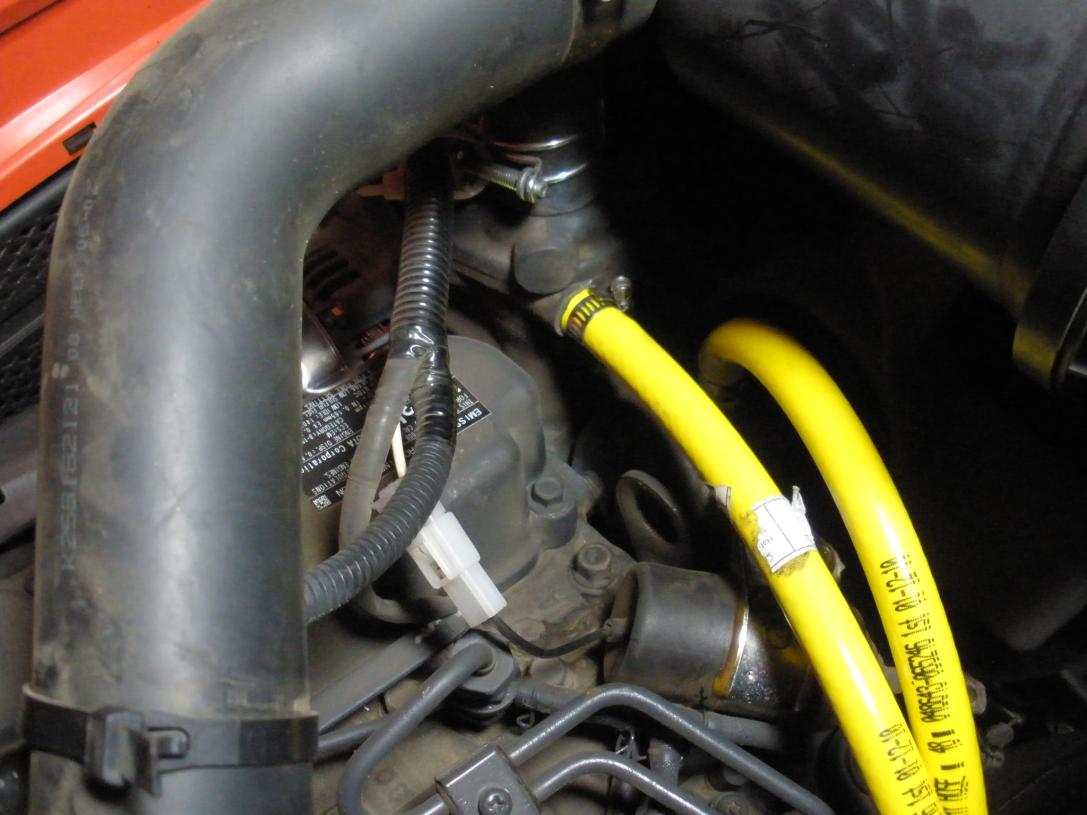

WOW, you have and engine in your B that is 33% more powerful than stock? I would love to see that engine !:eek::)
I have that same combo in my B7100, Look at my thread on the B7100 D750 to D950 conversion. It's not a lot of work at all, and yes you can tell the HP increase. ;):D

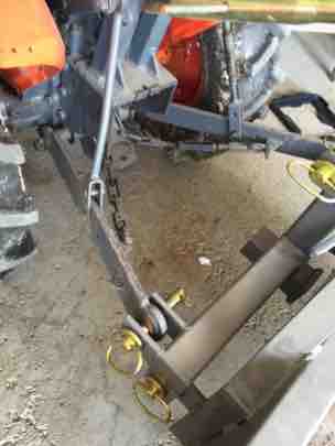

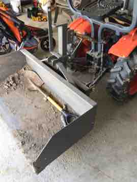

Can you post a picture of your three point setup?

I think a smaller rear loader would be more appropriate.
You have a small framed tractor not a large one. Keep pushing it and you will find an expensive failure such as when the top link assembly breaks off the tractor.

Glad I asked for a picture! :eek:
Well real simple your trying to do too much with the lift!
The three point on that model is rated at 400lbs at the end of the lift arms, and goes down as you move away from the tractor.
It's over loaded, by how much I couldn't tell you, but it's over.
Simple test to see if you have any issues at all with the lift, put 400lbs on a bar or plank on top of the three point arms and see if it will lift that, if it does then it's fine if it doesn't then we can look at other issues.
And no changing the pump will not give you more lifting power in this case.

I dont get it, that rear bucket has to weigh 150. So it will carry 250, maybe.
My L1501 will carry a 575 lb snowmobile on a pallet -barely. It does lift it, but doesent like it.

A stronger pump won't work? Would short arms help? The few vids they have on that loader they have it on a little 300 series john deere and it lifts it fine.

The only thing that I can see from the pictures that would help out is reconfigure how the lift arms attach to the bucket to winded them out as much as possible. That will bring the attachment a bit closer to the tractor which makes a huge difference. Grapes, don't forget dirt can be quite heavy. Fill a 5 gal bucket up and throw it on the bathroom scale, then see how many buckets you have been filling it up with. That will give you an idea how much you can go with it.
Another thought would be to cut that attachment apart and weld the A frame directly to the bucket. Then throw a hydraulic top link on there to dump the bucket. That would bring it closer to the tractor as well, but definitely more involved.
