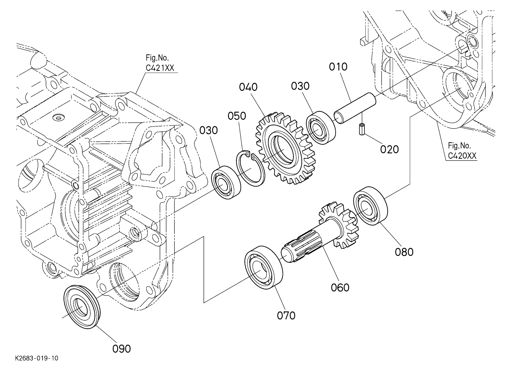

wow, sure is a LOT of work to replace #70 and #80 ! Bearings are only $25 CDN. Though 'while you're there', replace the #030 bearings too ??
chances are, if #70 and #80 bearings are bad ?, then #90 oil seal should also be replaced, but at least it can be replaced from the outside, i had to replace this seal on my mmm output shaft for my b2100.
