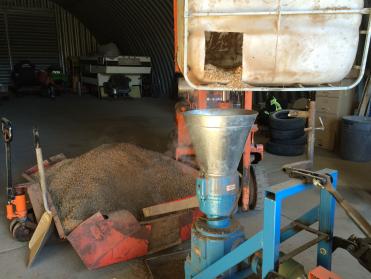

OK now i have another question,, well you started it,,,lol,, OK when the pellets come out I know they are hot and hence the moisture would be driven off. If say they went into a rotating wire drum with a fan blowing over them and as they would pass in to the container wouldnt that dry them out? Yeah Iknow more shyt in the game but I asking:confused:

Tumbling while hot/damp will break them apart,they just crumble. A little moisture is ok, i dump into trays to cool and then on my home made conveyor,as they go into storage a fan blows sawdust away as they fall through the wind.

Our electric bill is budgeted over the year. September bill came and was a 260 dollar credit. So i burned pellets in shop,where i worked every day and kept shop 70 degrees. I installed thermostat on pellet stove in house and adjusted stove to run hot. So instead of one bag/i went to 3 or 4 a week.
Moral of story- dialed down pellet stove is way less efficient. Running mine cranked up was About 2-1/2 tons between house and shop.
There is some hard facts about cost and efficiency of pellet stoves.
If i was to reccomend one, it would be a multi-fuel stove. Wheat, corn, beans wood pellets.
Guess tomorrow i will be running what i have,wet or really wet. Just going to cool them and run again. Running out of time and need to move out of my storage building.

The idea behind a multi fuel stove would allow the biomass to vary. Corn,wheat and several other crops are harvested when dry, and wheat can sometimes be found cheap or free due to fusarium which makes it worthless to farmers.
The price of the stoves is quite high, so i keep my eyes open for a good deal.
First one was 700 used. Works very well and holds 100 lbs of pellets.
Second one was given to me, very old and well kept. Heats the shop.

So, ran some through to cook off some moisture,6 hours and maybe $6.00 in fuel. I would be golden if it was pelleting first run. Guessing its over 1000 lbs.
may also use a smaller screen in hammer mill next test run.
Tooljunkie
May 13, 2014
4,150
35
62
Im using a gehl grind-all. Spooled that puppy up and i think it does a great job. The chunks may need to be smaller, so i will try next screen down. I have 4 screens,next one down is smallest.
My moisture tester is reading 23 percent moisture.
Rolling this through my head, i have a 15' pipe,12" diameter.
A bearing support on one end and rollers supporting top end. 15 degree slope and (regretting this part) my propane tiger torch heating pipe two or three feet from high end. May need to go lower depending how hot it gets. Slope will determine how fast wet chips pass through pipe.
As im writing this, i realize a friend has a wild rice processing plant, now defunct. Perhaps i should chat with him about drying my biomass.
Maybe he wants to part with some equipment.
Will keep you posted.
