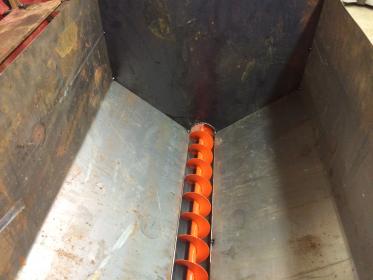

So, decided to spend a little time with pellet mill,added a gearbox and a 2 hp electric motor. Produces pellets slower but quality improved.
I also discovered the feed rate is where i was having issues.moisture that cooks out of pellets rise and steams the material above and tends to snowball.
Feeding slow enough to keep a small amount of chips to press reduces the accumulating moisture.
Building a hopper and 3-1/2" auger feed this week. Will post my results.

Pellet mill feeder pretty much completed, using a windshield wiper motor and pulse control. Lots of torque and delay should work perfect. I know need to make a video, but shop was tied up on weekend so couldnt crank up mill.
Video will follow soon.
