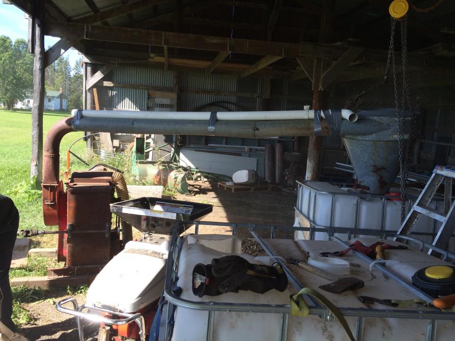

Vacation is over. Started the hammermill up today and prepped some stuff for pellets,spruce willow and maple is what is im grinding to size. image.jpg
Ingersoll groundskeeper 10 hp chipper shredder feeding into a Gehl grind all. It has removeable screens, i chose a 3/8" screen.makes something close to powersaw chips. The plastic tote tanks are my storage for chips as well as pellets for now. The cyclone works great, except when tank fills, then it blows everything out the top.

Bloody rabbit of the Grail,,,,lol,, Is that hammer mill a grain mill?

Could be,screens i have for it range from 3/16 to 3/4" holes. image.jpg
Making this size material.
Sitting at 13% moisture,ready to go into mill. A couple more totes full and i will have enough for a day of pelleting.

Vacation is over. Started the hammermill up today and prepped some stuff for pellets,spruce willow and maple is what is im grinding to size. View attachment 18175
Would like to grind and dump right into pellet mill, but not enough ptos around.

Looks to me like you have the chipper feeding the mill via a 6" flex tube -- how in the world to you get the material to move that far?
Re: the cyclone blowing out the top -- don't you get hints when the tanks are near full, like a Doppler sound effect? Would it help to cut a hole in the tanks and fasten some lexan or such for a window?
How many tanks do you use, and are they located in an arc so you can just swing the output tube from the full tank to an empty one? And I've gotta see how you empty the tanks! That has got to be some load when they are full!

Wood chipper is also a hammer mill,theres a big blower in it as it can also vacum leaves and small twigs.
The intention was to arc cyclone to each tank, but filling one tank is enough for one day.i just hoist cyclone and use forks to move tank.
I have cut a 12" square hole in the corner of tank, this allows me to even out chips in tank or it piles up in middle.
Replaced stove pipe to cyclone with 5" abs sewer pipe(new) now chips travel so much better.
I plan to raise tanks and lay on side, and just draw chips out corner hole using a hoe. Dump straight into mill.
