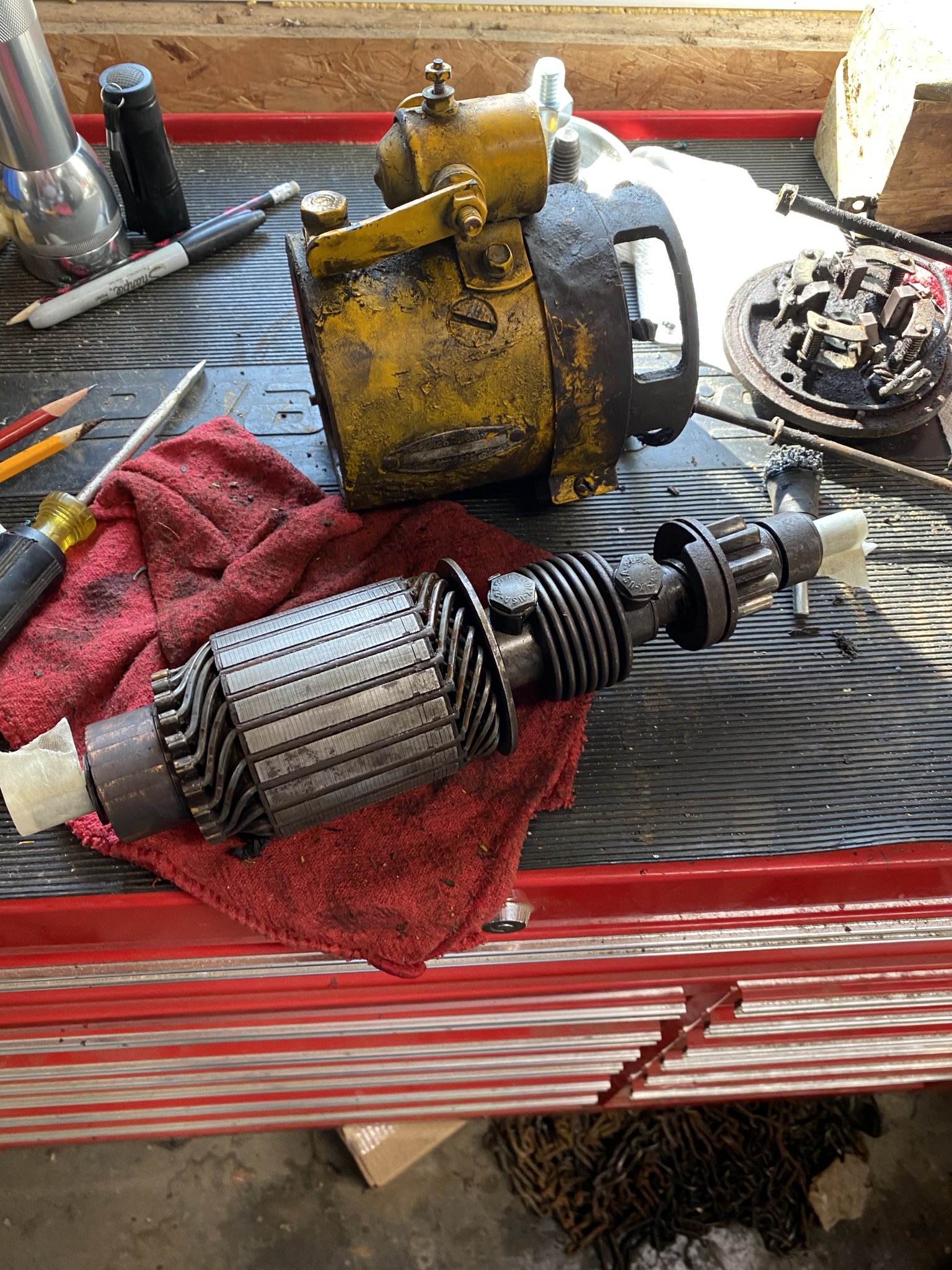

RCW, from your pic of the armature it sure looks like the commutator (the end where the brushes ride on) could use some cleaning and attention. If you know of anybody locally with a metal lathe they could turn that down for you. The mica insulation between the copper segments should also be under cut. Having that done along with cleaning/freeing up the bendix will have that starter operating like new again. The brush holders could also be cleaned and the general area removed of the carbon dust that accumulates over the years from the brushes wearing away.
If you don't have anybody locally and the armature could fit in a flat rate box and shipped somewhat reasonably.....I'd be more than happy to do that for you. You just pay postage. It's an easy task when you have the right tooling for the job.
I'll try and find some pics for you of another method I use that works great for cleaning up the insides of these and a lot of small motors.
And I still have my thumbs from growing up with dad's old MM "U"! :ROFLMAO:
Agreed.
And resist the temptation to polish the commutator with sandpaper or scotchbrite. People do it all the time, but it imbeds abrasive particles in the copper & in the insulator material between. That accelerates wear exponentially. Much better to have it turned.
