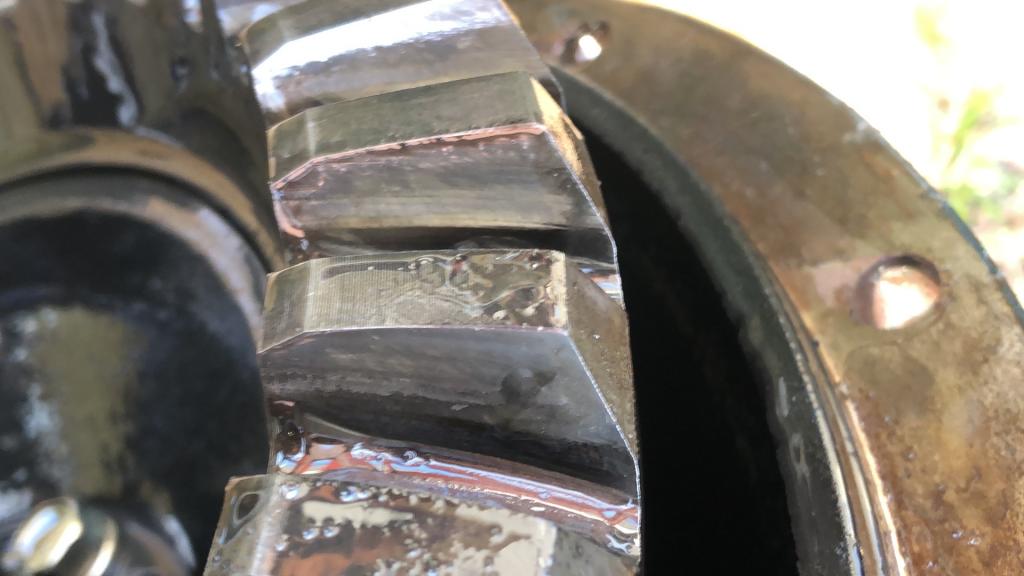

Yesterday The right front wheel started acting like it was going to seize. It would stop for a second and as soon as it got the pressure from moving forward it would free and roll. It rolls good and straight. When off the ground and spun it feels pretty smooth. The axle seal is leaking but it seems like no play in the berings.
I pulled the tire and axle hub today. The case has some metal shavings in it but no pieces like chipped or broken teeth.
The previous owner was saying how he just put wheel seals in this side before I bought it. I'm thinking now that may have been the problem. There are 3 shims spacing the wheel hub from the pinion.
After pressing bearings in and out for the seal could it be spaced too far apart and need less shimes to ride deeper in the teeth?

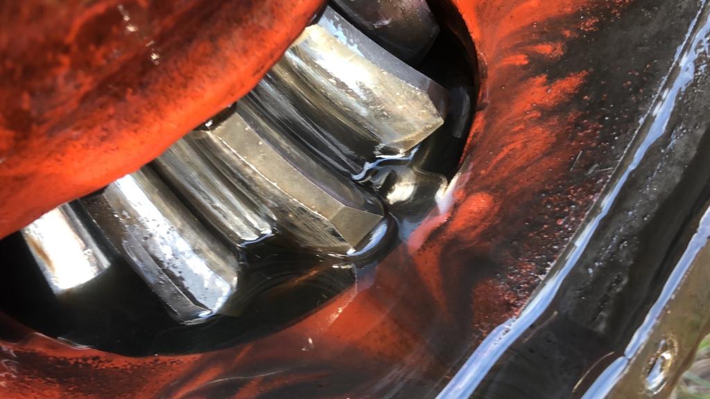

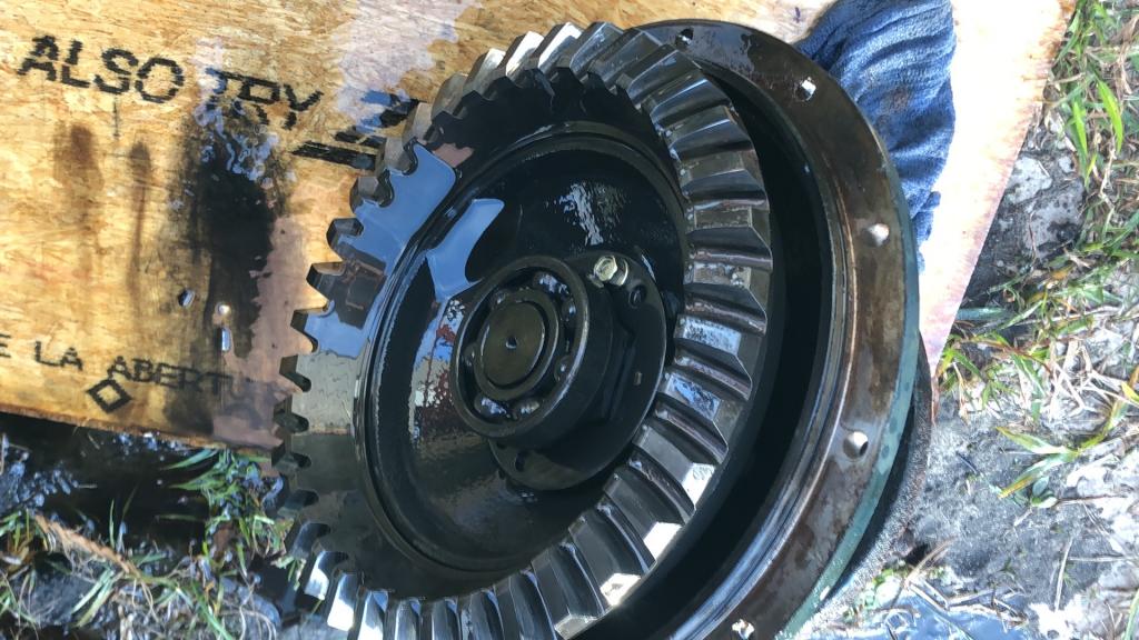

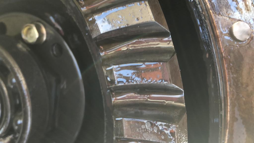

Yes, it is parked and torn down.
I added pictures.

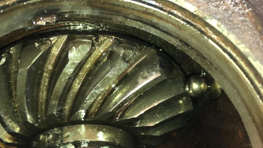

I think I should go into the knuckle part to see those gears also. The edges of the bevel gear and ring gear I see are sharp on the upper edges on one side. It's like they are not meshing deep enough but why? Has the bevel fear lowered or was this not shimmed properly when the seals were replaced?

The bearing are not press fitted, every bearing on a kubota is a fine tolerance fit.
You have something seriously misaligned as you can see xtreme wear on the teeth.
Get the WSM and it will explain how to set it up properly to get the teeth to mesh like they are supposed to.

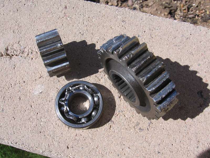

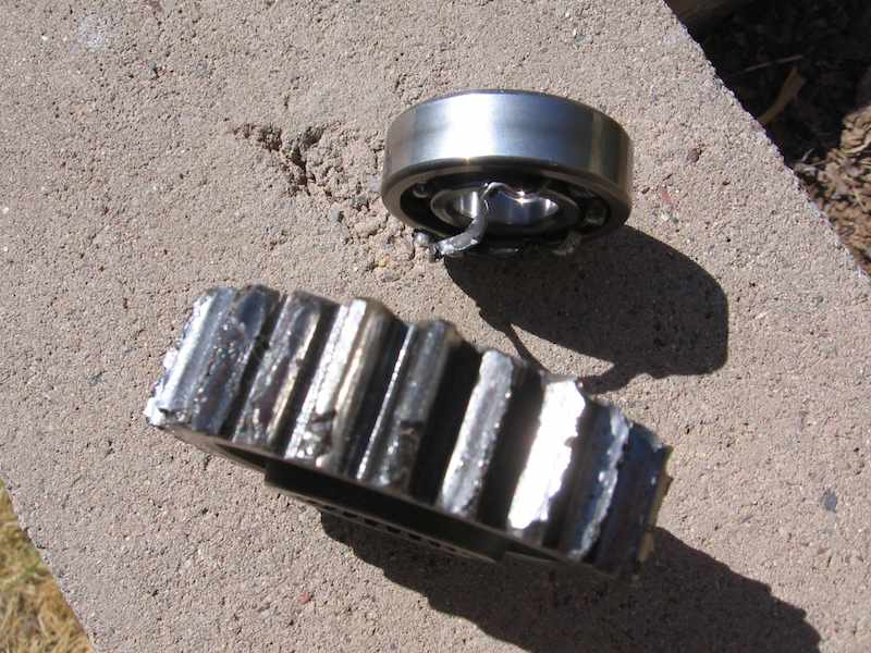

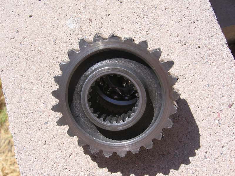

I am not familiar with your tractor at all, but this sounds a lot like a buddy's problem with a Yanmar. He bought the tractor in pieces from a guy who had disassembled the hub for some reason. He reassembled it. Neither apparently knew what they were doing, and the hub failed almost immediately, breaking the gears. He bought new parts, and A MANUAL, and we assembled it, and it worked. (and it is still working) Turns out either the first or second owner reversed the order of assembly of a gear & a spacer, which drastically reduced the engagement of the teeth.
Your 4th & 5th pic show an almost identical setup to this scenario. In the Yanmar, that ring should have been located behind the gear, not in front of it.
Again, I know nothing of this hub setup, and this maybe totally off base, I only offer it as a possibility. Your results may vary.

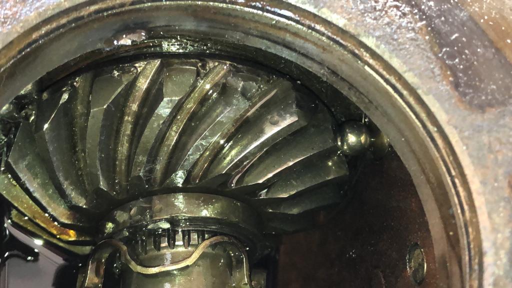

Today i looked it over more closely and when I stand it up as it would be on the machine with just the casting sitting on the bench the unit spins free but when shaken the outer bearing does have some play. Maybe 3/16" at the ring gear.
I think the bearing is bad and perhaps from improper assembly last time. I'll order a bearing and seals while we look for the WSM.

As advised I dug in a little further and I also found the WSM.
The king pin bearing appears to have let loose. The balls fell into the bevel gears and that what I felt. Teeth snapping with ball bearings rolling around in there.
2 bevel gears, 6 bearings, several cir clips and snap rings and all the seals $1,100 or so.
The 2 berings at the end of the axle shaft look good and feel smooth but with 14,500 hours it might be best to just replace them and the seal at this time. They did see some polluted oil for some time.

The gears and bearings and seals are all back in and after 2 weeks of using it there are no leaks and no noises. Thank you Lord.
