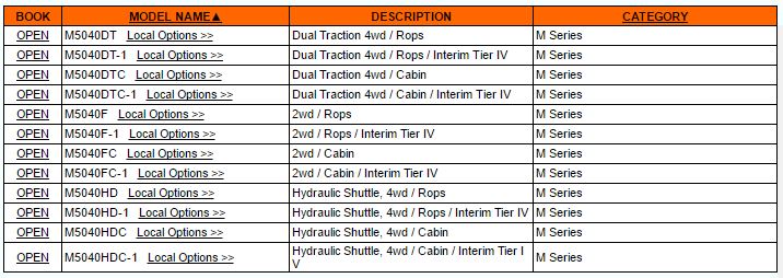

In order to give you a more accurate answer to your issue I need to know what exact model you have.
If you don't know get the serial # and give that to me. ;)

This is why I was asking for a specific model #, what Lugbolt is saying is a know and common issue with that model.
If the issue only effects one direction it could be an adjustment issue. ;)

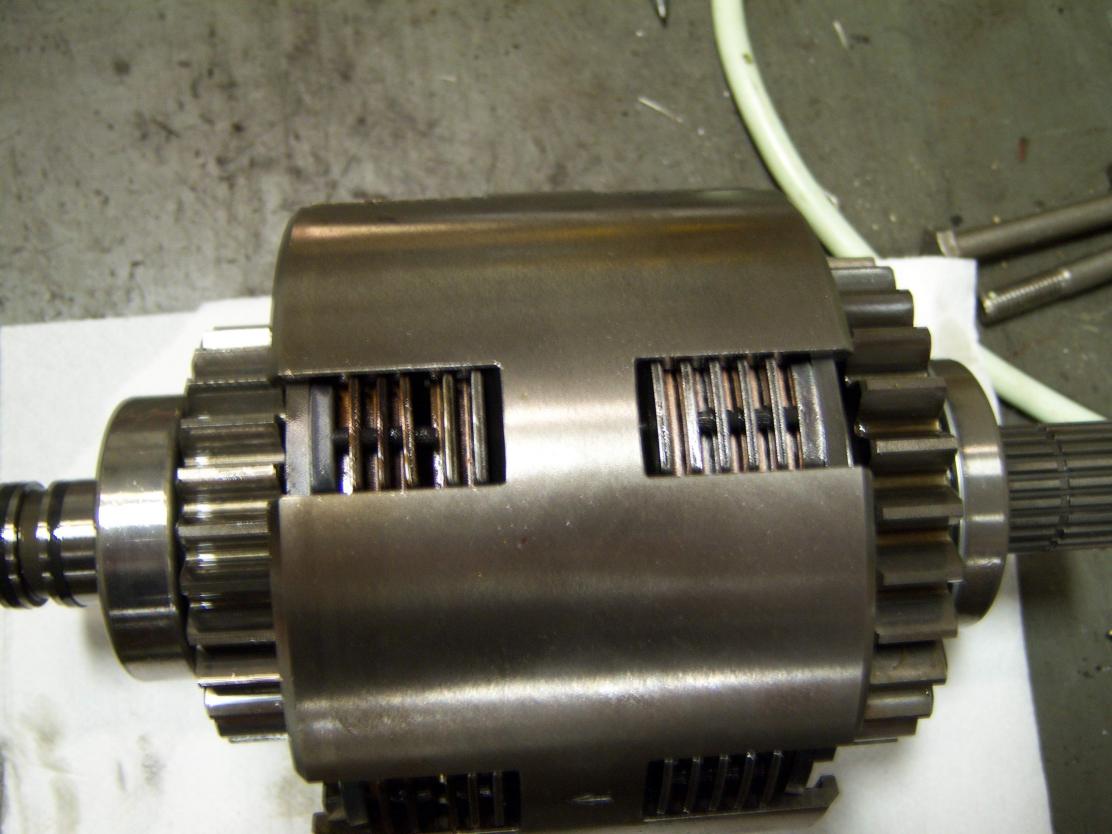

Wet clutches grab (engage) when the piston presses the stack together forcing the oil OUT of the spaces between the disks and slip plates. Oil getting between them causes them to SLIP, not grab.
If the plates and disks are not flat, dragging can result (creeping or pulsing in neutral), even with the pressure removed from the piston. See attached wet clutch pic - the left side has a warped plate and heat damage. (This unit dragged hard - needed new plates)
Dragging is most noticeable in the lowest gears (most gear reduction, most torque). Inconsistency in the fluid makes dragging worse.
The pressure in the forward and reverse clutch stacks should be balanced in neutral. If one side drags, adjusting the oil supply can mask it, and restore apparent balance. But a warped disk will continue to drag until someday replaced.
Warped plates are caused by excess friction heat, most commonly from hard use and contaminated oil. With clean oil and easier use RoBoss's M5040 may remain usable as-is, if not perfect.
