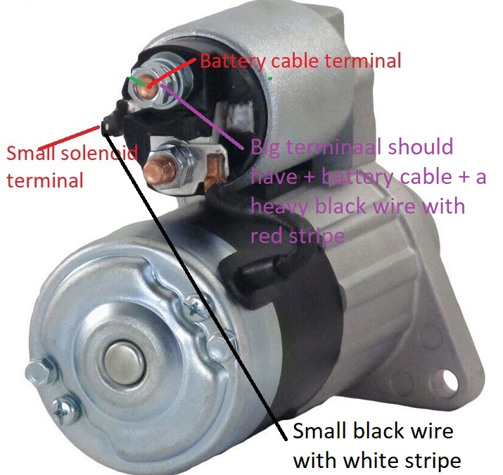

On Monday, I could not start the tractor. The glow plug indicator would glow orange like normal but when I would try to start it the starter would just make a noise and not turn over or catch. I ordered a starter and put it in yesterday...now it will not even heat the glow plug indicator. Now, in the process of taking the battery cables on and off, I cracked the positive battery terminal. There is a screw with a wire on each battery terminal. I'm not sure where the wires go. Also, if you are looking at the side of the tractor facing the starter there is a wire attached right behind the starter at the far right side. I can't find that part name or number anywhere. Is that the wire that goes to the glow plug indicator? I would greatly appreciate any help...I use my tractor to put hay out. Thank you!

It sounds as if the work to replace the starter goofed up some wiring.
When you turn the key to 'start', the small wire on the starter should receive +12v (this spins the starter)
Make sure this wire got reconnected when starter was replaced.
However: you say that at this point, the GP indicator does not even work. Look for some wires which are not connected.
