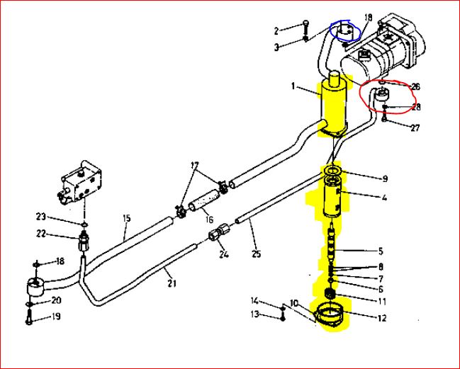

The red (smaller line) is the high pressure
The blue larger line with the filter canister (yellow) inline is the suction line.
This model does not have a suction line screen that would be located either in the rear case or in the start of the suction line.
if you haven't pulled the filter canister apart I would do that and replace the filters.

Hello all. I wanted to say thank you for all the help. You guys are great. The short story is that I got it working.
That diagram is great, I did open the bottom of it and LOTS of hydraulic fluid started coming out (engine off). How much fluid should I be prepared to lose out of that? Anyway, I closed it back without completely opening it until I knew how much fluid I was going to lose.
What I did to get it working was to crack the high pressure hose (engine on) that goes to the hydraulic lever to control the front bucket. It bubbled for about 5 seconds and then I had to duck to miss the spray coming out. I shut it down, tightened the hose, restarted it and it works just fine now.

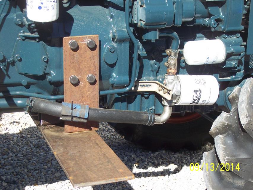

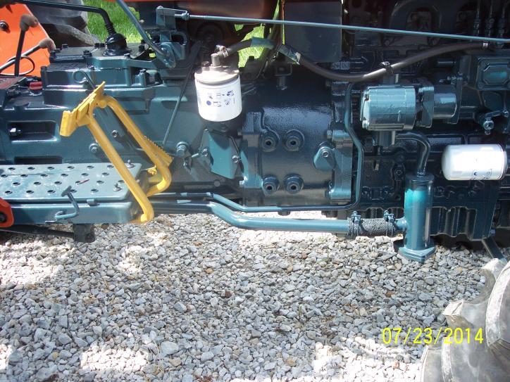

Forwheeler, here's an option I did on my L305. It's a smaller tractor then yours, but appears to have the same filter setup.
NIW give me the guidance to get it completed. About $25 in parts, a little time and you have an easy to service filter.
First picture is the old, then the new.
That mounting bracket was something out of my "bone pile" off of a window AC mount. Sad to say, it's still on there!!
