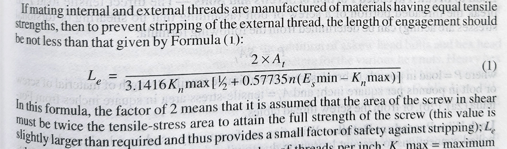

One of the great things about tractors is that they involve all manner of engineering principles. For many of us this results in a curiosity and we dig into things that we might have learned and/or forgotten a long time ago.
Anyway, to that end, I did dip into my Machinery's Handbook this morning and compared 1/4-20 to 1/4-28 bolts with similar and dissimilar materials, and looked at bolt/thread failure. The relevant section makes the point that failure can occur due to the bolt breaking, the bolt threads stripping or the internal threads stripping ... kind of obvious. It's not hard to calculate the amount of thread engagement required to "guarantee" that the bolt breaks rather than the external or internal threads shear.
I ran those calculations and for a 1/4-20 bolt there needs to be a minimum of 0.173" of thread engagement for the bolt to break. For a 1/4-28 bolt there needs to be 0.195" of thread engagement for the bolt to break first. The 1/4-28 bolt has a higher tensile strength than a 1/4-20 bolt of the same grade so there needs to be more thread engagement to allow more torque that breaks the bolt.
Going down this rabbit hole showed me that while a 1/4-28 bolt is stronger than a 1/4-20 having a higher tensile strength, the opposite is true for the threads in the mating component. I ran some more calculations with a Grade 2 bolt in 7075-T6 aluminum, and the shear area of internal threads for a 1/4-20 and 1/4-28 bolt, when compared at the same 0.173" of thread engagement, is 0.093 in^2 and 0.090 in^2 respectively.
In conclusion, fine thread fasteners are stronger than their coarse thread equivalents, but internal fine threads are weaker than their coarse thread equivalents for the same thread engagement length. For this reason, and since the thread length is fixed for the drain plug, I will retract my suggestion to tap with fine threads.

The equation for minimum thread length engagement is shown below. The example I give above of 0.173" of thread engagement for a 1/4-20 bolt is well under 1D and that already has a small factor of safety built in. But these "rules of thumb" are useful for sure, and I'd be all warm and fuzzy with 3/8" of thread engagement for a 1/4-20 bolt.
Engineers seldom build to minimums. I dont think you will find many engineering drawings with tapped hole depths at less than 1D. Those shallow deprhs would be used when some other feature interferes with the hole or its a through hole in a thin wall.
