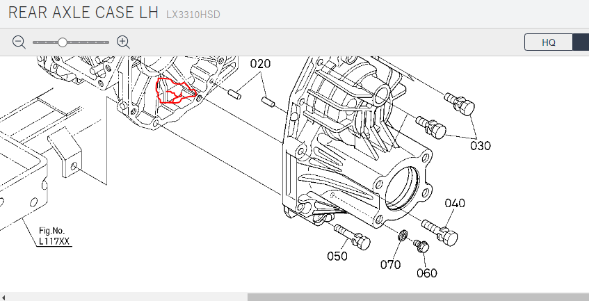

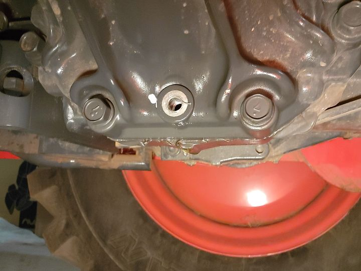

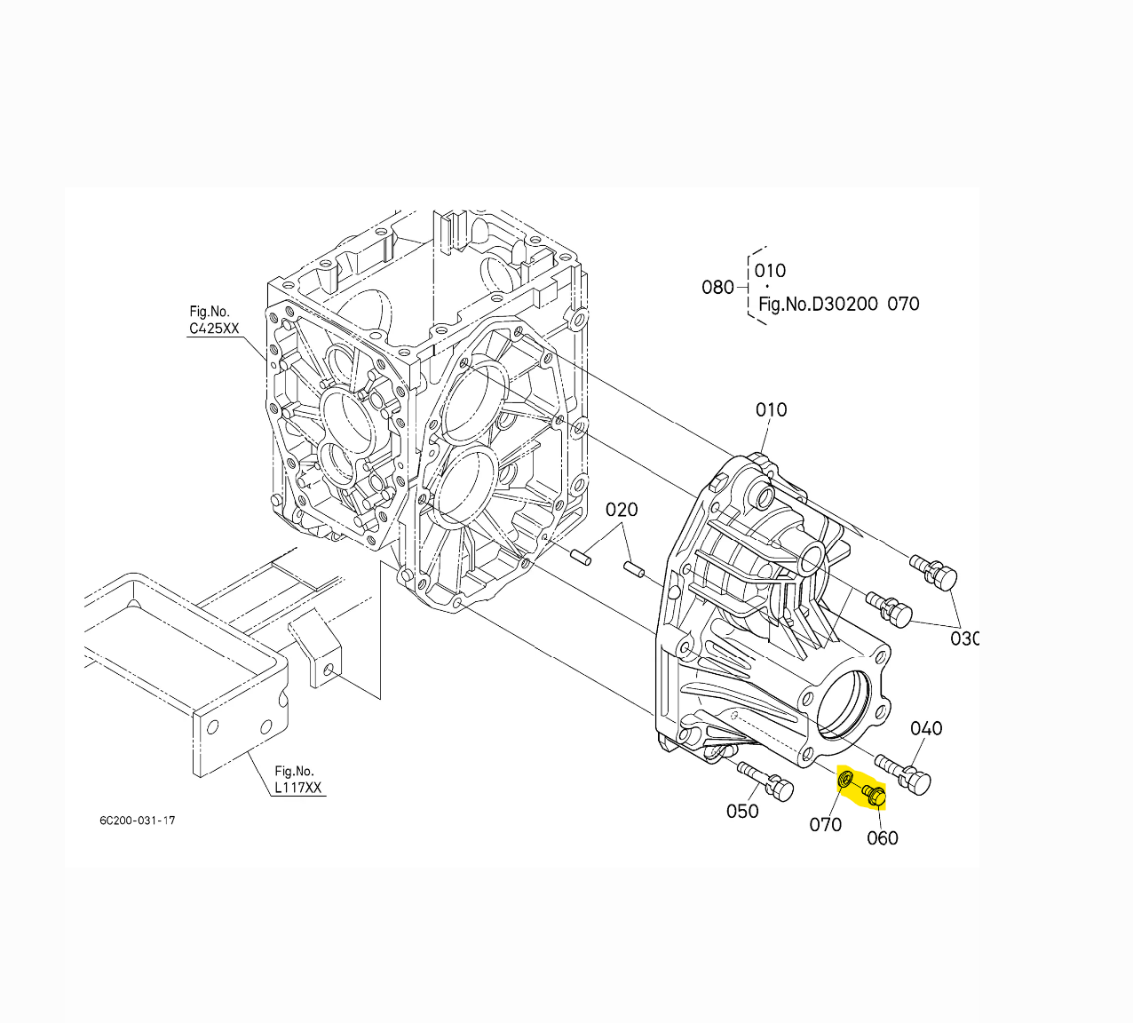

This is the first tractor I ever owned/operated. I attempted to do the 50 hour maintenance on it, and it pretty much turned into a disaster. In my defense, I have changed the fluids and filters in my regular vehicles for years with virtually no problems. But this tractor isn't set up anything like my car or my van!
I managed to find the engine oil drains, so I drained the engine oil, installed a new oil filter, and reinstalled the drain bolts. But, I read the manual wrong and poured about 3 quarts of engine oil in the transmission fill hole. 😫 I couldn't understand why the dipstick said that the oil was so full, until I realized I put the oil in the wrong hole...
Then I realized that I needed to drain the transmission/hydraulic fluid. The diagrams in the owners manual are terrible, so it took me a while to figure out where the drain by the PTO spline was. I unscrewed that bolt and let the fluid drain out, but I couldn't tell where the other 2 drains were. So I scoured the internet for about 2 hours looking for clues, and I watched several YouTube videos. But there were no clear images of exactly where the drain bolts were, and there were no videos or pictures of LX3310 drain bolt locations. After staring at the underbelly of the tractor for a while, I reasoned which bolts to pull. Fluid drained out, so I figured I pulled the right ones (I did). After all of the oil was drained out, I reinstalled the bolts. Only, I didn't realize that the rear axel case was made out of ALUMINUM, and being a weak female, I used a cheater pipe on the end of the ratchet like I usually do. Because otherwise I don't have the strength of a man and I can't get bolts very tight. Needless to say, I ended up striping the drain bolt hole on the Left Hand rear axel case. 😭
So, I called the Kubota dealer and spoke to someone in the service department. He said that I didn't need to have the transmission flushed out as long as I drained the oil out. Then he asked me for a picture of the bolt hole that was stripped, so I texted that to him. He called me right back and said that this was "the worst possible place" to strip a bolt hole. He said that the bolt holds the 2 halves of the case together, and that there is some tube inside the case right next to the drain hole, and there isn't enough metal to tap a new hole without damaging the tube. So he said that he would need to send someone to pick the tractor up, and they would have to order a new left hand axel case. I asked how much that would cost, and he said $400. for transport and at least $6,000 šŸ’°šŸ’°šŸ’°for the repair. And then he said that if anyone tried to drill or tap a new hole, that would void my warranty on the transmission.... 🤬
Well, my B.S. detector went off because what he said didn't make sense. Like, how could a drain bolt connect into the other side of the metal housing? If it did, nothing could drain out of it. So I went online and found diagrams of the left hand and right hand rear axel case. The diagrams confirmed that I only pulled out the short drain bolts, and they do not hold the covers on. The diagram for the LH cover does not show me what is on the inside of that cover, but I can't see any tubes or pipes in that diagram. So I looked at the RH rear axel case diagram, and if it is anything like the LH side, there is no visible tube in there. So as far as I can tell, it seems that the service guy either doesn't know what he's talking about, or he's trying to rip me off. 🤔
Does anyone know if there are any tubes/pipes in the left hand rear axel case next to the drain hole?
Is there any kind of low cost fix for the stripped hole that won't void my transmission warranty? Like JB Weld, Loctite, silicone, etc.?
I spoke to a local guy who has fixed tractors and heavy equipment for 40 years, and he said that he could fix it with a Helicoil, and he didn't think there would be any tube right next to the drain hole. But, it sounds like that might void the warranty??
Attached is a photo of the LH rear axel case where I stripped the drain bolt hole, a diagram of the Left Hand Rear Axel Case, and a diagram of the Right Hand Rear Axel Case.

I cannot see any relationship between the pic you posted…and the diagrams you posted… They do not appear to be the same part at all.
But I agree a helicoil is likely the simplest fix…and there’s no way that will ā€œvoidā€ any warranty. Any dealer who claims it does is merely wrong. It is a often-claimed B.S. that ANY ALTERATION you perform on equipment voids the warranty. The modifications you do without Mfr’r approval….Must be Shown to be the DIRECT CAUSE of the failure.
Kubota would have to prove that the helicoil contributed directly to any failure….and that would be almost impossible to do.

If you helicoil the hole and it doesn't leak, then who is going to know the difference? The second thing is if you need to tighten something and you don't have the strength in your hands, then buy a long-handle torque wrench and use that instead of a cheater pipe. I will bet that you didn't have a good light underneath when you were working on the tractor, otherwise, you would have recognized that the case was aluminum when you looked at the hole to put the plug back in.
I had my shop lights and a Petzl headlamp, and I could see. But everything was painted gray from the factory, including the filters and bolts, so everything looked the same. I just had no idea they would make a transmission or this rear axel case out of aluminum.
If they don't appear to be the same part at all... it's probably because the first diagram only shows the top view of the left-hand rear axel case, and they don't show the bottom half where the bolt hole is. The part in question is labeled as #010, and the oil drain bolt that goes into the hole that I stripped is labeled as #060.

I get all of the suggestions of using a helicoil, but I'd probably drill out the hole to the next metric thread size up, tap it and buy a new plug and washer. If the mismatch bothered me enough I'd drill and tap the other side too so that they're the same. I'd use a fine thread pitch tap which results in a stronger thread compared to coarse thread pitches.
@GeoHorn, I think that 090 and 100 on the second schematic do a better job of showing the drain plug and its relation to the housing.
