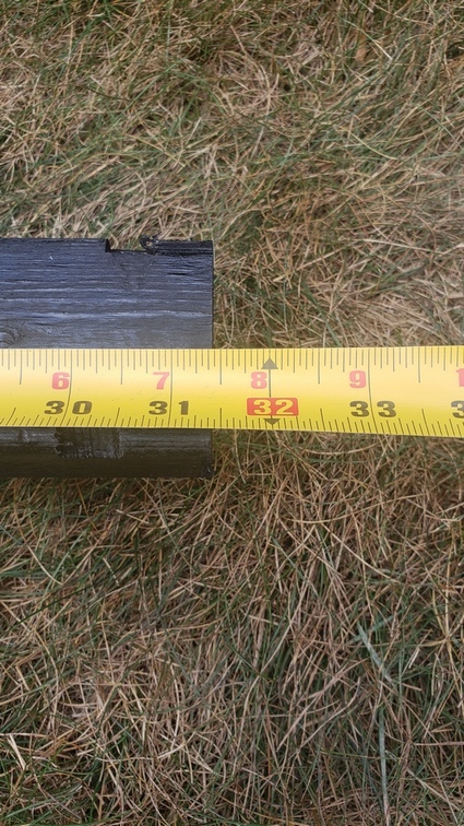

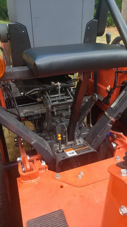

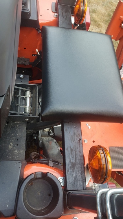

Used a 2x3 just under 31-1/2 inches and mounted a seat on it 15wide by 11deep. It attaches to the tractor with one pin on the bottom as shown which is basically pulling it down to secure it (The other pin at the seat hinge is just to disassemble for easier storage). The 2x3 has small notches as shown on the ends to accommodate the tractor(lights) bolt heads. The seat 'post' is a short piece of pressure treated baluster and is plenty strong and is pinned with a 3in x 5/16 pin. The seat is made from a piece of 1/2inch finish plywood, marine vinyl from the fabric store and some 2inch cushion foam (also from the same store).

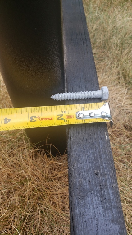

I just glued the seat to the 2x3 and added 3, 2in lag bolts for good measure.. Your back rest is actually the back of the swivel seat and the setup works just fine for jobs where you're using the backhoe for short periods and needing to move the whole machine again and again. If I'm going to use to backhoe in one spot for a hour or two I simply have to only remove that bottom pin (about 10sec) and remove the seat and use the swivel seat for a little more comfort.
Footnote: When I bought my machine my dealer told me that there was no seat option for the BH77 (along with my LX2610) and you "had" to use the swivel seat. Well I got sick of swiveling pretty fast (worst case up to 20 times in one day) so I had to come up with some alternative. Somewhere in this thread I've learned that there is actually a seat option but it 'may' require an extended frame but perhaps not.. Certainly more $$ and with no option then to use the more comfortable swivel seat occasionally. I'm still thinking now that my added seat is a more useful quick fix for me and I can still use the swivel when I want too.
Hope you find this useful. Thanks.
