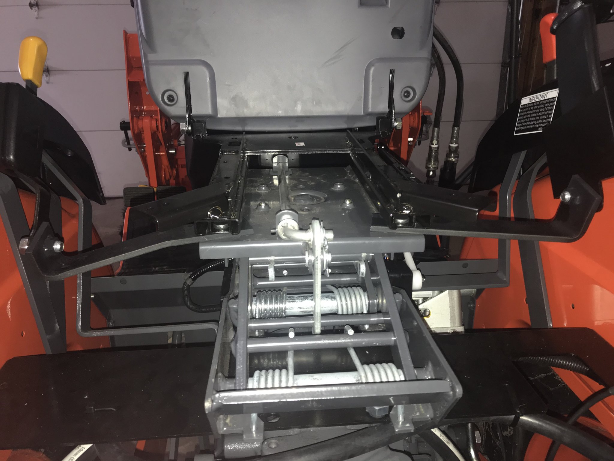

This is how the seat at attaches to the b77 with the extensions to fit a cab model b2650. If your dealer will let you order a la cart, you wouldn't have to purchase the swivel seat at all, just the cab model seat and post.
Do you think the seats Will fit back to back without the extension?

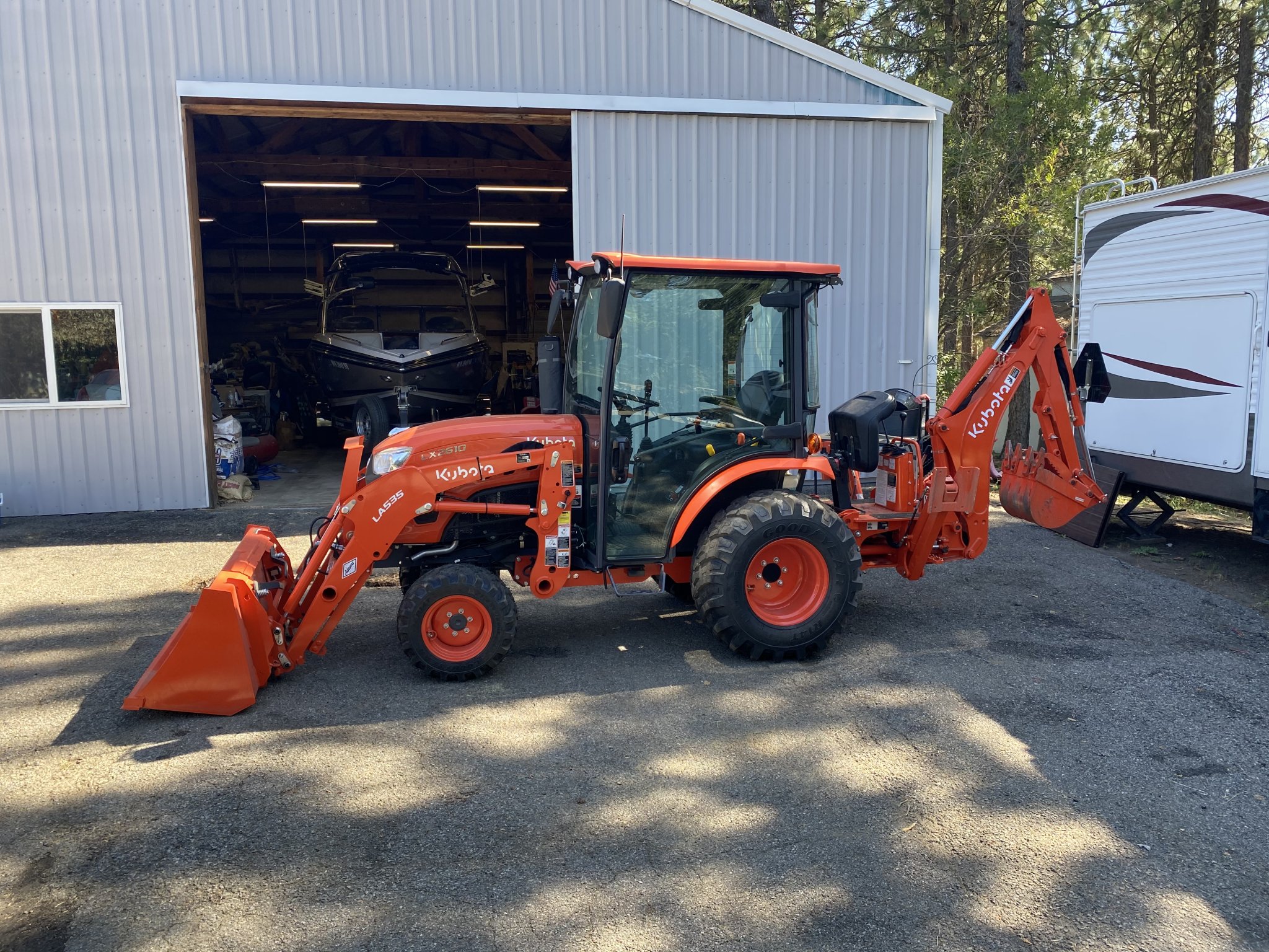

LX2610HSDC with BH77. There is definitely less legroom with the dedicated backhoe seat than a swivel seat. Some find this unbearable. I personally don’t find it to be a problem, and at 6’6” 290lbs, I’m not what one would call little. If I had a ROPS model, I would not give up the suspension seat for a swivel. I’m at about 190 hours, with about 50% of that in the backhoe seat. Swivel seat would definitely be more comfortable for backhoe operation, but giving up the suspension would be a non-starter for me. BB997864-F4D0-4F33-AF89-9457E1EA1004.jpeg

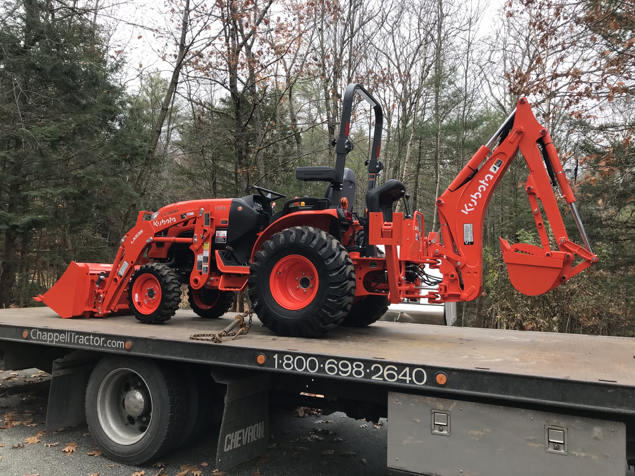

New tractor arrived! Thanks for all the help on the swivel seat decision... note it did not require the extension to keep the two seats, just $300 extra for the backhoe seat / post.

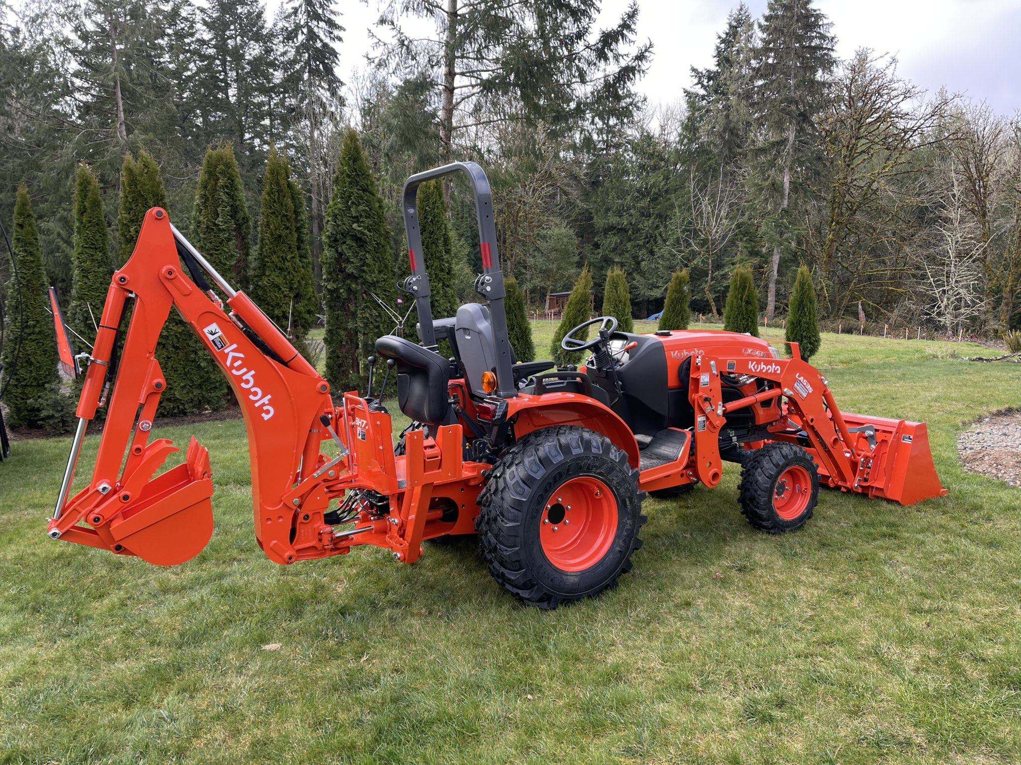

Just wanted to post an update to close the loop. Dealer installed the cab subframe kit (same price as ROPS kit) but did not install the cab spacers. This is the only way to go in my mind on the LX w/BH. Both seats fit without even having to fold one up, assuming you’re not over six feet tall and you can slide the main seat forward a bit. Plenty of room for me (5’11”). I highly recommend this. Cheers all. 67B7C3E8-9DC3-4CD6-B0D9-56A1DEFB8E25.jpeg

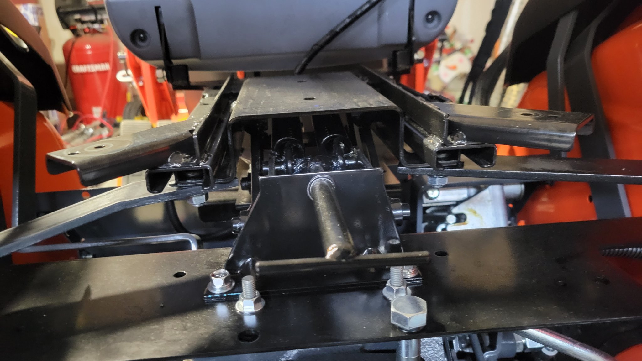

Here you go. The t handle is used to increase/decrease spring tension.

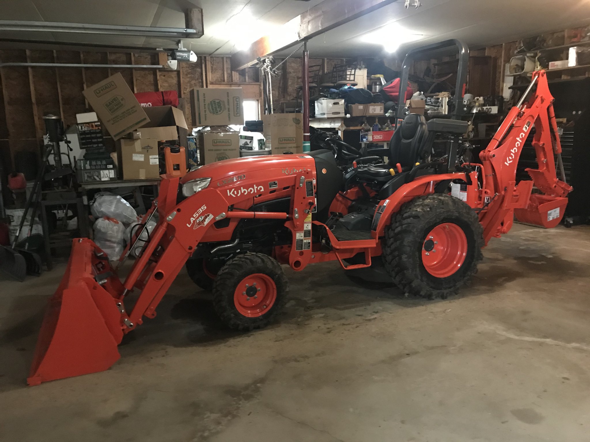

Thanks! Yep mine doesn't have any of that, there are some springs but just to assist in the lift and spin, and to activate the safety switch. So once I sit on it I am basically sitting right on the bottom and the only relief is the seat padding. Hopefully the dealer will understand and work with me to fix this. AD1EA023-4692-4FA0-B325-D0219ABA8DDF.jpeg

Hi Tim,
My lx2610 with loader and Bh curled up (as pictured) is just shy of 18 feet long by an inch or so. The top of the Bh is 79" tall. Hope that helps!
