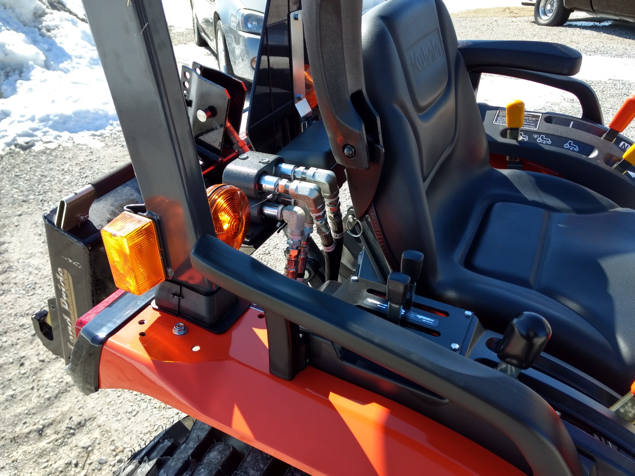

The only issue with putting 1/2" remotes on it the physical room. Not sure unless you offset the remotes by for example adding a nipple between the block and the coupler that you will be able to fit them in the space you have.
I use 1/4" for all of my rear attachments just because of the extra room to grab the sleeve of the coupler...
The photo is the Kubota rear remotes on a LX2610HSD

Thanks for the picture. This is helpful. I do plan to use 1/4" where I can. But I also rent a fertilizer spreader in the fall which has 1/2" connectors, and didn't want to alter the rented spreader, so was thinking a hose with 1/4" on one side and 1/2" on the other.
For you specifically, did you put those on yourself? I just ordered one rear remote kit, and wasn't sure if it came with the couplers pictured or if you had to purchase those separately?

That's the way it came from Kubota. I had ordered the tractor with them. What I'm not positive about is did it come from Japan like that or did my dealer install them. I think it was dealer installed and those are the couplers that were in the kit. My Kubota 3rd function ( the hardline one) did not come with couplers I used 3/8" flat face ones there because I have the grapple on and off quite a bit.

Thanks that makes sense. This LX was my first tractor, and I wish I had ordered more things up front instead of installing them later (3rd function, rear remotes, canopy, etc.)
