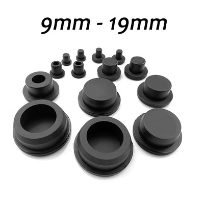

What about making some sort of cover that can be removed for greasing?
I did not find good photos of the loader grease zerks to see what the possibility is.
14,225
6,392
I'd be inclined to find something along the line of a plug. It would be inexpensive, less likely to be knocked out, and easily replaced.
On the digging boom of a Ditch Witch they had threaded openings at the fitting and a pipe plug was screwed in. Needed an allen wrench to remove, so a nail or pick of some kind was needed to remove dirt, but the fitting was always clean.
