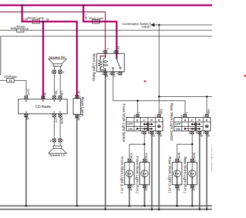

Here is a picture of the wiring from my WSM. Not sure if it will be of any help or not.

Thanks. I guess Ill take off the dash & headliner to follow the wires to find a place to connect a switch.
So weird to me. They've got the dash hole, covered with a rubber face plate, and the plug-ins for rear lights. You'd think the connector would just be right there. Plug in switch, plug in lights.... and go.
