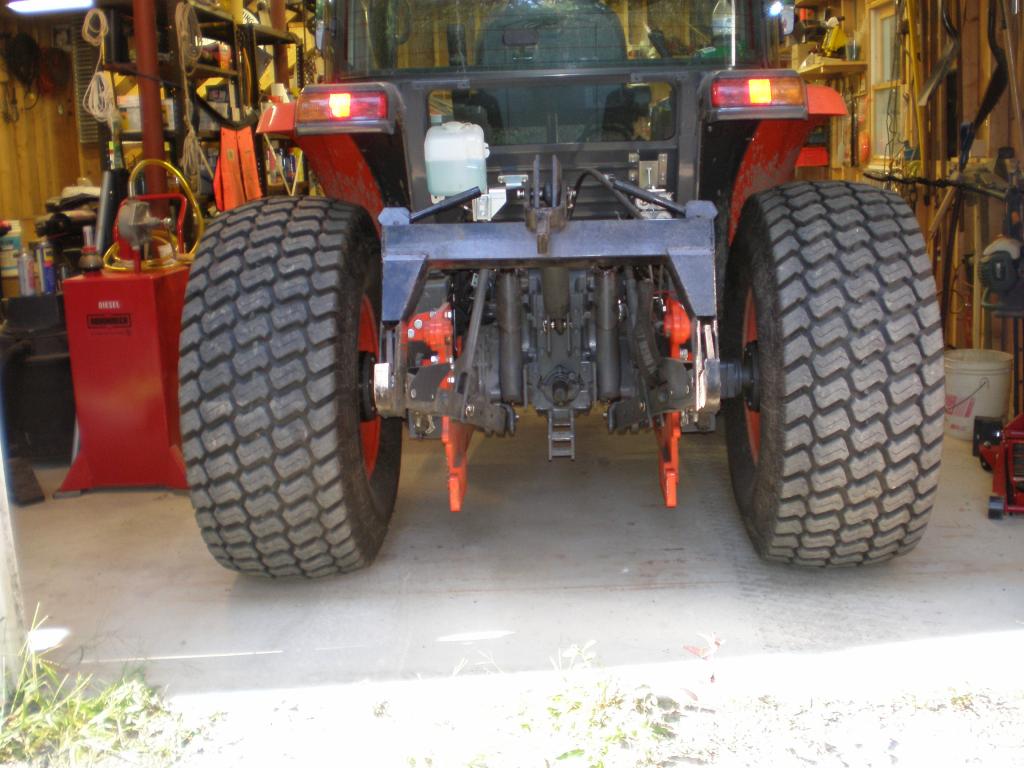

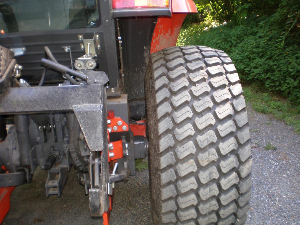

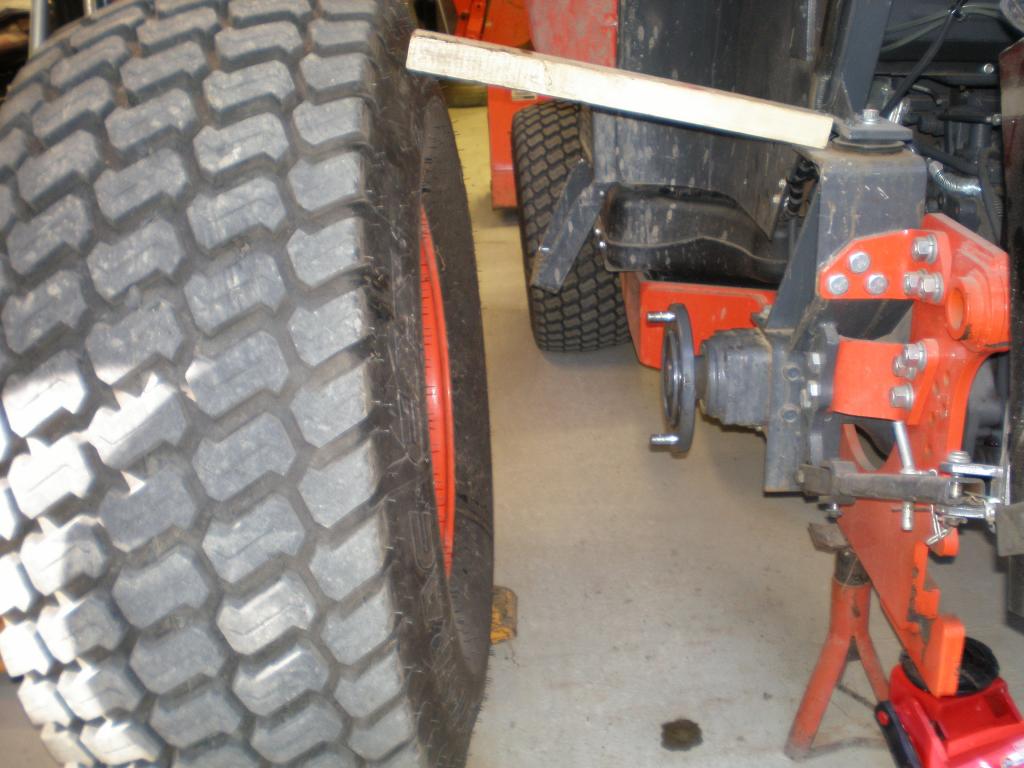

Looks good.
Are your rear tars filled?
When I installed my spacers I was surprised how damn heavy they were... :eek:
I also put anti-seize on the studs/bolts....

I put fluid film on the threads and surface when I put things back together and torqued the bolts to 100 ft. lbs. as stated in the manual.
Unless the manual says otherwise, torque values are understood to be for clean and DRY fasteners. As a rule of thumb, if you are going to apply anti-seize or other lubricant, reduce the specified torque by 5% to avoid over-stressing the threads.
