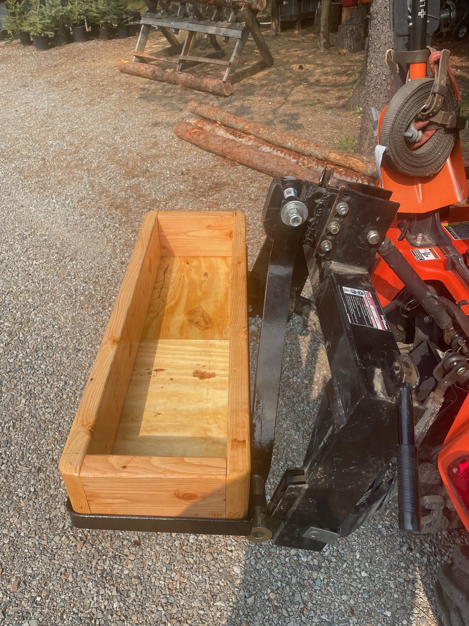

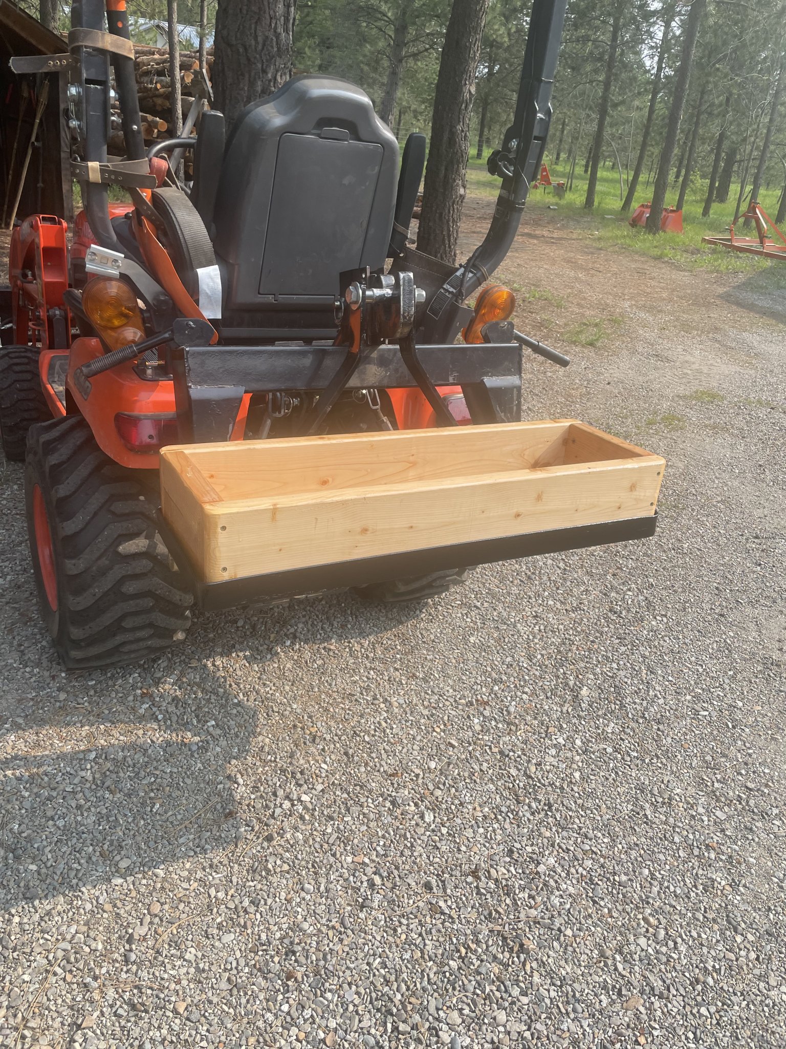

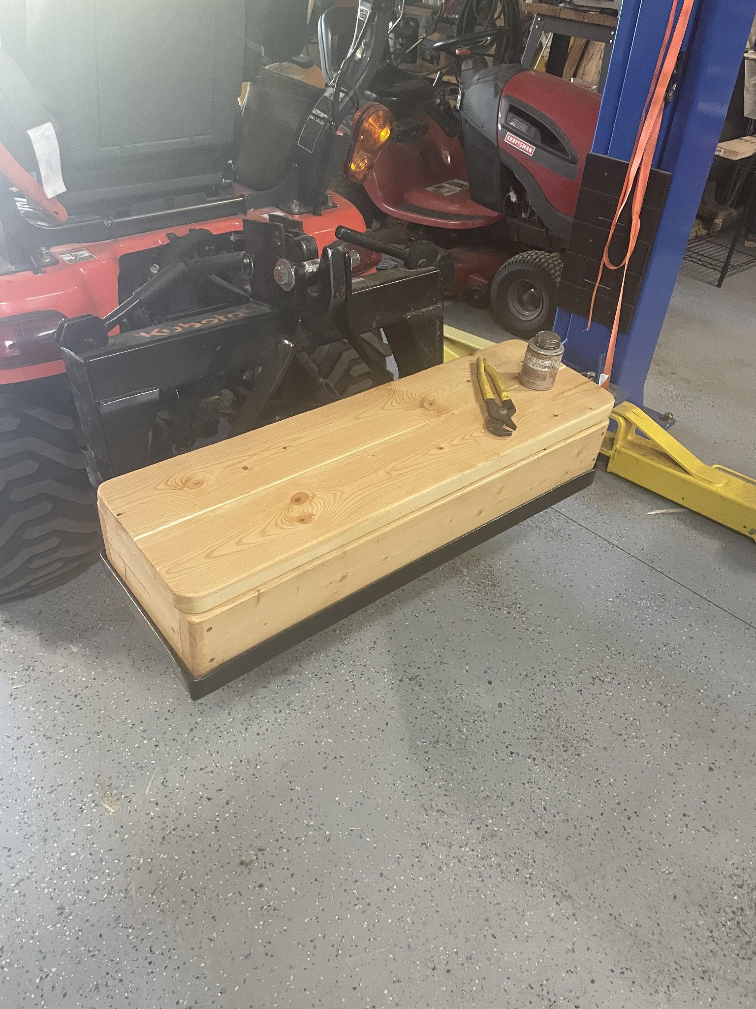

Always a problem carrying tools, chainsaws, parts etc. Took apart a wooden crate, and ground the rust off an old piece of angle iron, a little cutting, welding and a few screws, now I can carry needed items with me.
A solid lid to use as a work bench too. I’ll mount my chainsaw carrier to it as well.

Nice. How is it mounted to the three point?

Like Grizbota, I would also like to see pics of how it is attached.

It’s scrap metal from my metal pile built, mounted on a ( harbor freight) quick hitch. I had 2 sets of pin extenders, so although new parts, they didn’t cost me anything. Top pin is a 6” bolt with a cut off piece of gas line steel pipe over it. I’ll get a pic of it off tomorrow.
Some black tractor paint and a quick coat of poly on the wood. I’ve used it every day since I built it.

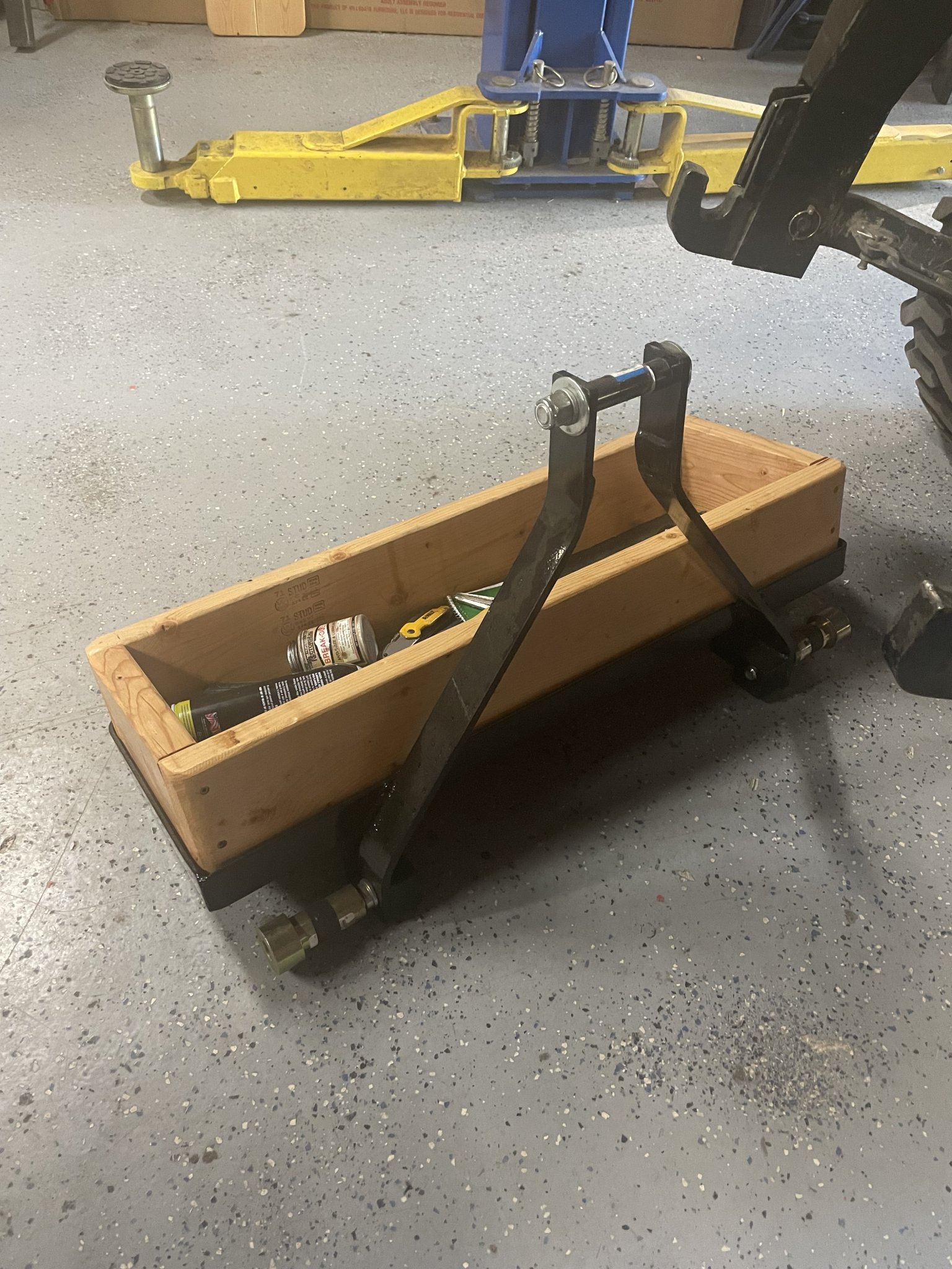

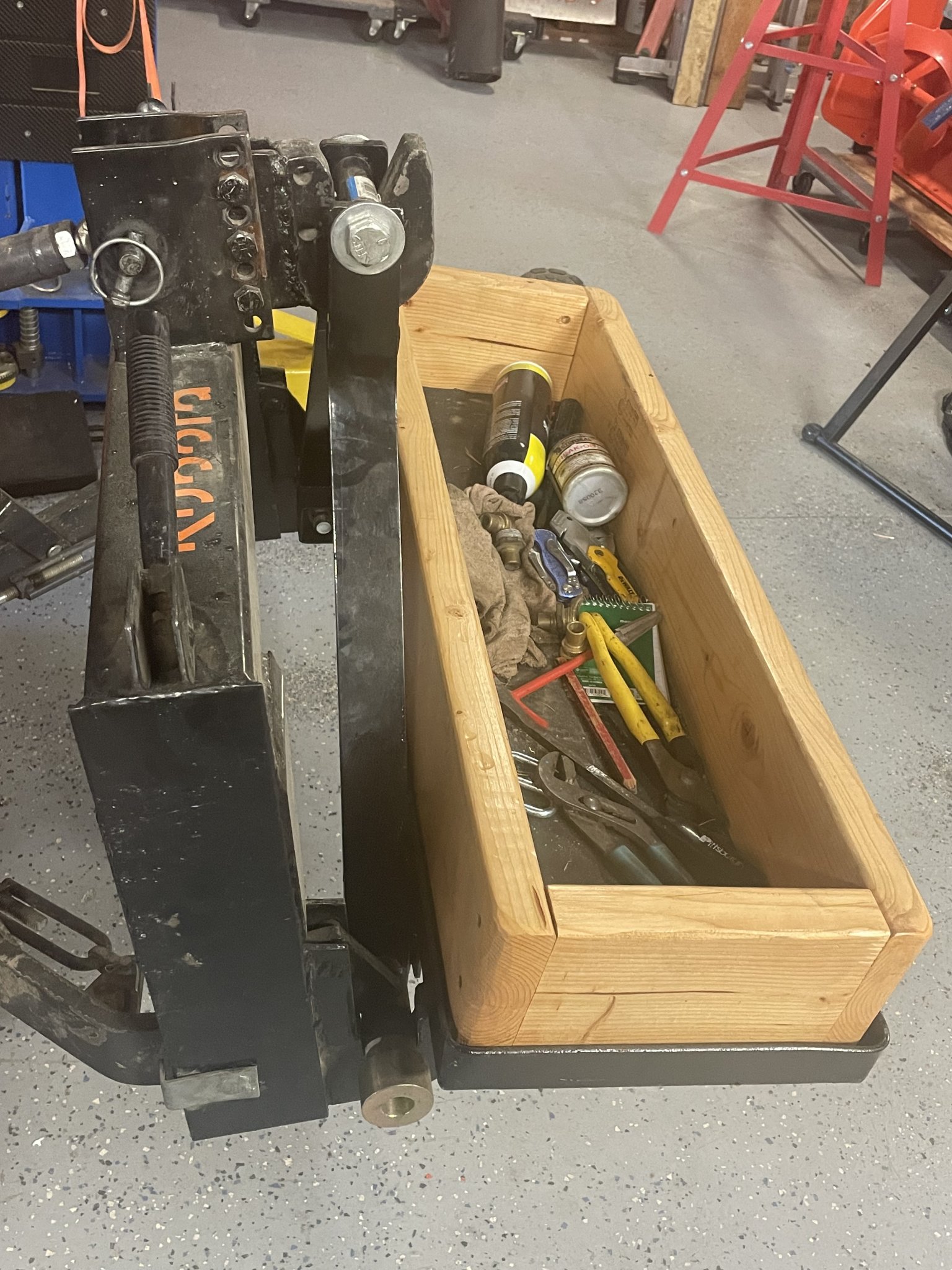

Here’s a couple pics with it off

I wonder if some small legs would be helpful in regard to making hook up and disconnect a little easier?
I was thinking about some stiff legs or wheels, but it’s pretty light, so I can just unlatch the QD levers pick it up and put it somewhere.
