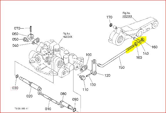

Tuckler,
I don't think your talking about the same turn buckle, I think your thinking top link.
Here's a picture of the adjustment for the feed back.
Lugbolt said turn buckle, but it's more of an eye bolt setup on that model.
