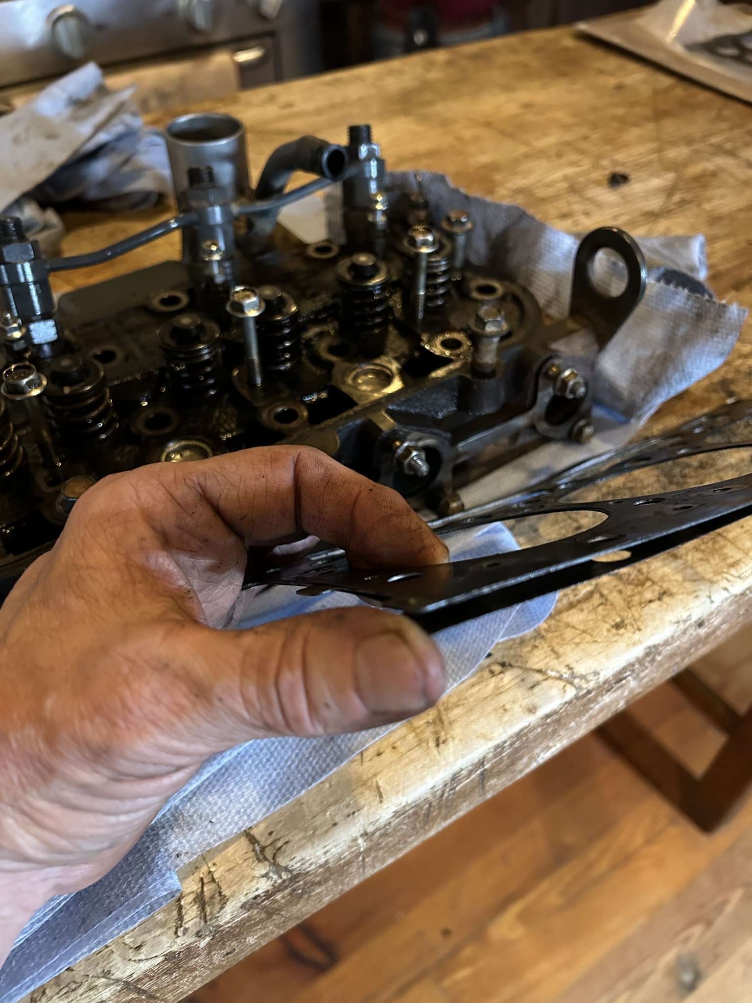

Check out the bottom valve. When push rod came out of rocker arm, the tappet fell on top of the lifter. That cylinder was full of water. The metal gasket is pulling apart. Am I safe to assume that’s not normal and just get a new gasket? Push rods are all straight and all valves move freely.
Torinodan
T1600, G4200, G5200, Ford 2810, 1974 Wheel Horse C100
Oct 14, 2021
199
94
Fayetteville GA
You have a valve stim tappet floating around in there too.
Workerbee
Zd21
Mar 1, 2020
321
185
MN
Is the piston coming up to the same height as the other two? That water in there could easily bend a rod
34,361
9,594
Did you find the missing valve cap?
You need to check the head for cracks, take a picture of the bottom especially around the valves.
The head gasket delaminating could be an issue, but they do that sometimes when you pull them.
Coolant could have been trapped in the head when you pulled it and just dumped into that piston.
As others said, you need to check for height of that piston as coolant in a piston will bend the connecting rods and or damage the piston and or rings.

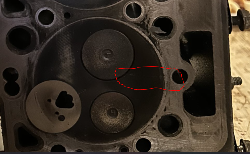

Thanks guys!! I did find the cap. No damage. Here is the bottom side..
34,361
9,594
None of the sealing surfaces look good. :(

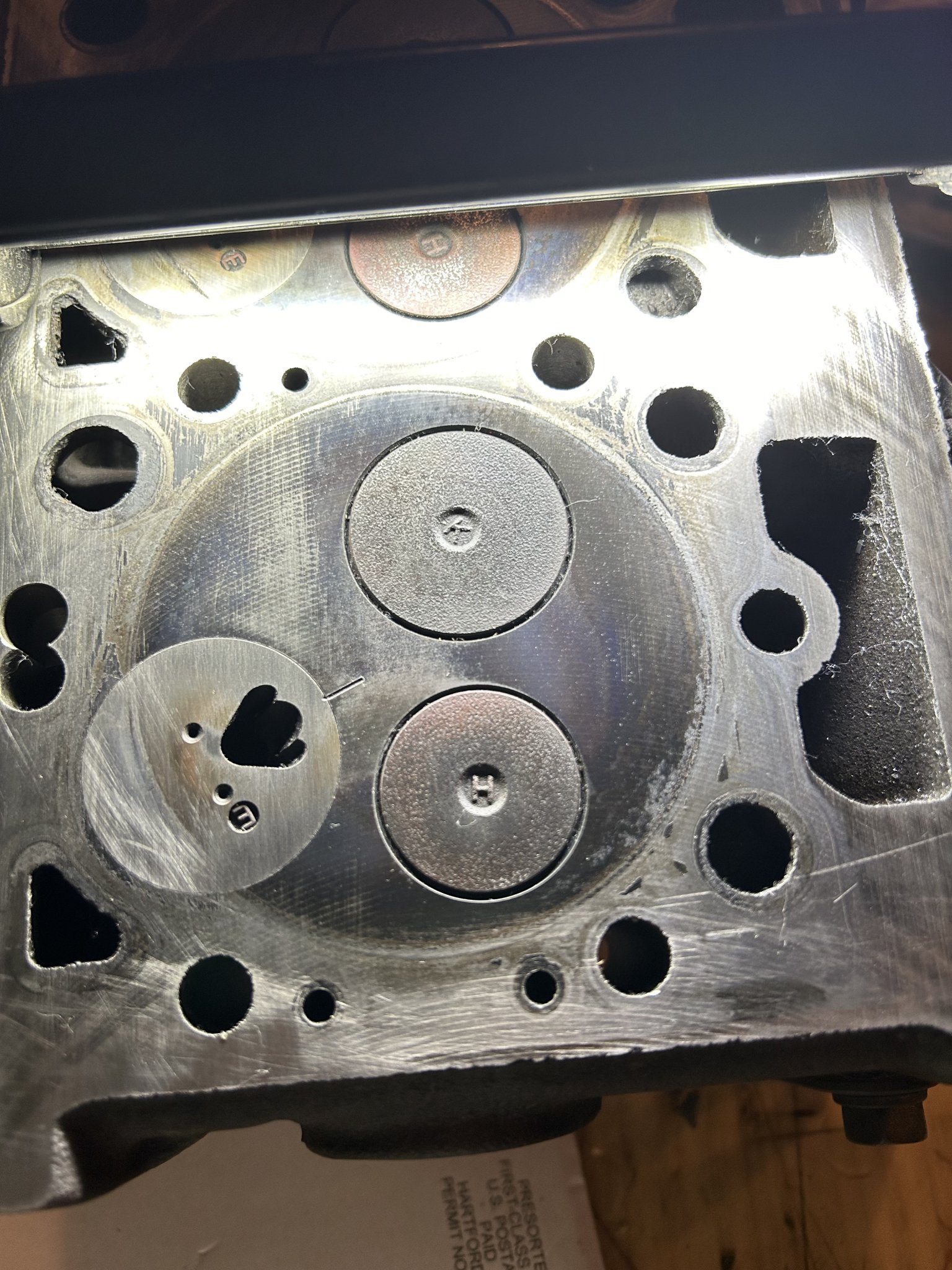

This looks possible?
34,361
9,594
Ok that looks better.
You really need to resurface the head.
I use a huge piece of sandpaper glued to a piece of very flat hardwood plywood.
Or you could send it to a machine shop to have it done.
