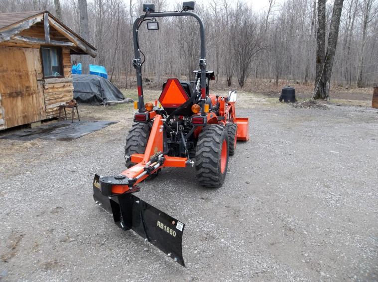

I like my Land Pride RB1660. It was well under your $1000 budget (and I'm in overpriced Canada) and it covers my tire tracks at full angle with the B2620.
The hydraulic angle was an option, and with it you have to pull a pin on the hydraulic cylinder to reverse the blade. No big deal. It also tilts.

looks like the RB1660 only offsets about a foot. I'm thinking (which isn't always a safe thing to do) that being able to swing the entire blade over like some of the others would be more useful. Course it seems like the further outboard its cutting the more leverage it will have and the more likely for something to go wrong in a hurry.
