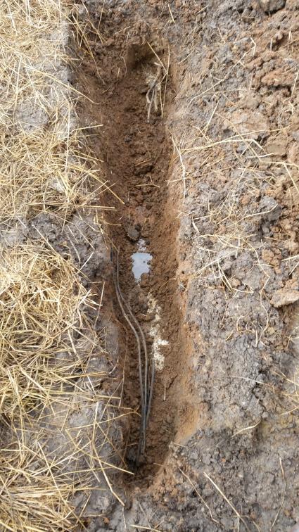

My brain cells started percolating, and I though why not call the guy who has the oil lease on my place? He actually has no wells on my side of the road, but we help each other out and he may have some equipment to find electrical breaks.
He came down this morning and in 10 minutes had the problem pinpointed within inches.
He disconnected the lines at the meter can and hooked up a transmitter and a ground rod a few inches long stuck into the wet ground. The receiver was a bow shaped tubing with spikes on each end about 2' apart and arched up about 2'. He had a meter he set on top of the bow.
He walked a few steps put the receiver in the ground, picked up and walked another few steps. Proceeded with this process a few times, then backed up a few feet, then forward, then twisted it 90 deg. then moved a little more, then back. Then he tells me the break is right where his left toe is!
He told me Tri Plex direct bury wire is a good tough wire, but when it's nicked it eventually gets all three wires.
I put a rock there and start digging.
I got it visible, but had to leave. So we'll get it back together tomorrow. I looked like I'd been in a fight with a pig and lost!

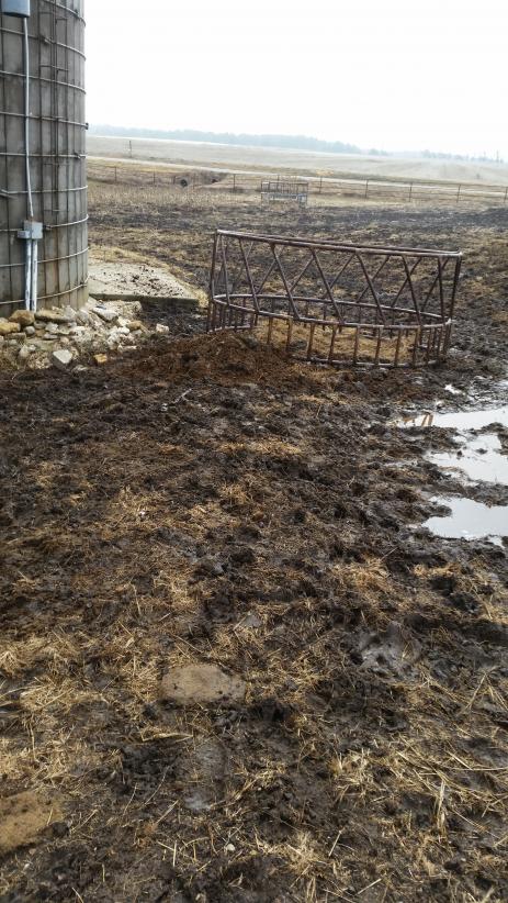

Frank, I think I caused the problem! I used my crawler to make that terrace and it caused an abrasion on the insulation, I'd imagine.
I made a terrace right on the edge of the silo to redirect water that was coming between the silo and the barn. I have to cross the terrace every time I go get a bale of hay and then when I put the tractor back in the lean-to. So, as I mutilate the terrace I eventually have to rebuild it. I'm quite sure the rebuilding got the wires injured somewhere and the problem grew!
The terrace was built after the wire was buried. Therefore it is shallower then original and now in that one spot is about 14" of bury.
Oh, I have a check in my pocket to thank him for the grief in the mud!
I think I will leave the hay ring around the area after it is repaired until I get some sand and fill most of it with that. But I will leave something above the wire for a locator. Maybe a cut piece of blue tarp!
