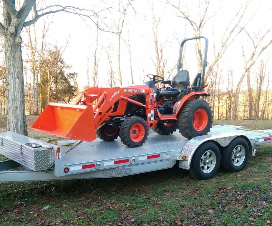

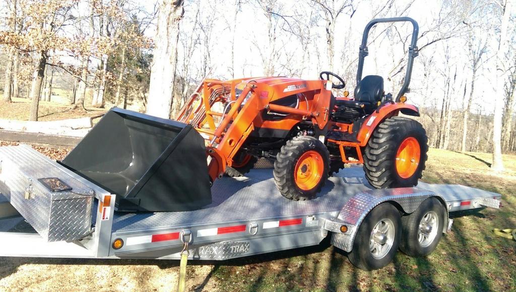

here is a shot of it with both my B2601 & my bigger CK4010.

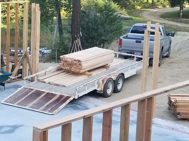

Here is a pic of my 20 foot trailer, it has no issue whatsoever loading anything no matter how low slung it is.
I don't have ramps per say, It's the entire width of the trailer, and it will haul tractors, trucks, equipment and lumber. :D
