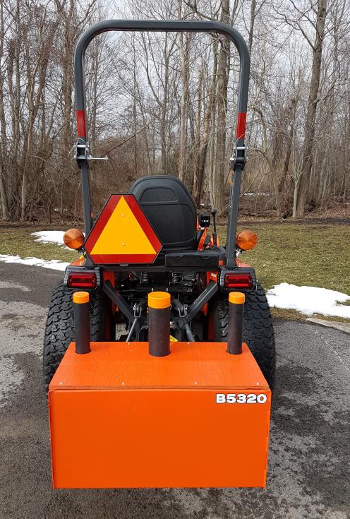

WoW. 1000 lbs ballast. Other than adding the back hoe accessory (I wish!), What would you use to get up that high on weight? I don't think any of the ballast boxes would do that.

This....980 pounds. Really makes a big difference.
What are the dimentions? Looks to be roughly 2' x 2' x 2'. Am I close?
Did you use bags of concrete or made it part of a concrete pour from a truck?
I can't remember the exact dimension, but 2x2x3 I think. Held 12 bags of quikcret. I couldn't get the local cement company to pour it, even taking it to their business. Said I would have to order 1 yard of concrete.

Counterweight, counterweight, counterweight,,,,, did I mention counterweight? Get it on there before something bad happens! A backhoe attachment, loaded tires And a heavy box blade, concrete in a barrel anything that weighs near as much as lift capacity or what ever the manual specifies as adequate, and get use to the controls of your new machine so your able to feather them.
