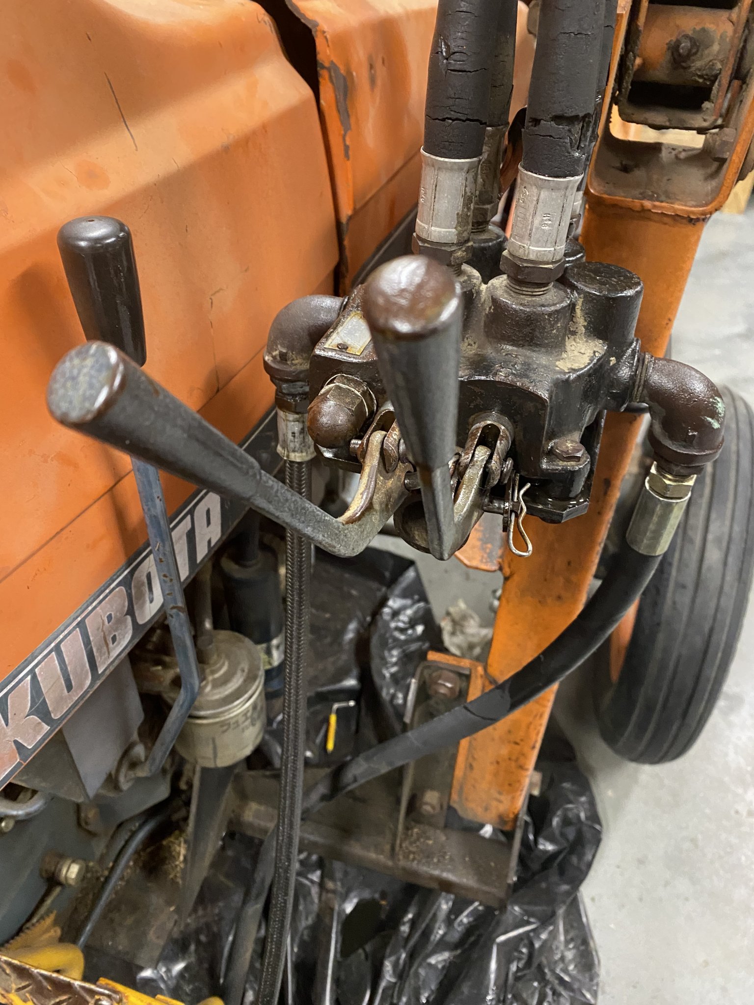

So working on my l285. New hoses, new hydraulic pump, new fluid,cleaned filter and took apart the controls for the loaded and cleaned it up. Now I can raise and lower but no curl. When I use the handle ( outside handle for curl see pictures) it makes the hoses jump and wants to kill the engine. Any help out there? I’m lost at this point . Thanks

did you check to see if your couplers were seated properly?
BX23-S,57 A-C D-14,
13,213
5,871
hoping that's an OLD picture, cause those hoses look BAD !
something in the 'curl' system is plugged or deadend
BTW are those street elbows rated for 2000PSI ??

It's dead heading, by the looks of things there is a good chance of crap in the hose.

Which hoses jump the ones to the side of the valve or the ones to the cylinders? Do they jump when the valve is actuated in both directions or only one?

Couplers seated properly? On the controls? Put on new o rings and they seem to be seated if that’s what you mean . Can you tell me what you are referring to . Thanks for the reply and help
yep hose are bad haven’t replaced them yet as they didn’t leak. Need to get that done. Thanks for the
The hose on the side of the valve jump . I need to verify if they jump when trying to curl the bucket down or up, had to walk away last night and take a mental break

Something is plugged or not connected. The hose jump indicates that the pressure is spiking. Hopefully the relief valve is kicking in and preventing damage, but I don't think so. Tractor stalling suggests that the pressure is rising so high the engine can't turn the pump. Pressures that high can cause catastrophic damage, so don't do that any more until you have located the source of the problem.
Since the hose jumps but the relief apparently does not kick in, the problem may well be at the valve port itself.

I suspect you have the hoses reversed going to and from the valve

Guessung is not usually productive. Disconnect the two outside hoses at the loader and put them in a bucket. Start the tractor and verify you get flow out of each hose when you operate the bucket control lever. The flow should alternate with the lever. Forward should be one hose and back the other.

The spool valve (Loader valve) that you have is a two line setup with no tank hose, thus there is no over pressure protection in that old valve so be very careful as an over pressure can burst a hose or burst a seal.
I think just to be clear and cut out the guessing game, give us a back account of why you changed hoses and hydraulic pump.
What was working or not working before you changed anything?
Why did you change the hydraulic pump?
Is this the pump that bolted behind the injection pump or is it one on the front of the tractor?
Where did you get the new pump?
Was it a part number matched pump or model matched pump?
Did it bolt on perfectly with no modifications?
The reason I ask is on several occasions I've seen hydraulic pumps that were installed that were actually the wrong pump and ran backwards.
Why did you change the Hoses?
I'm assuming from pictures you mean you replaced just the supply and return hoses.
Did you replace them one at a time or just took them both off and replaced them?
Is there any chance that those two hoses got swapped?
With a two line valve swapping power in and Power beyond can have some very weird outcomes.
You said you took the spool valves apart, did you do one section at a time or all of it at once?
Is there a possibility that you could have swapped the spools from one to the other.
While the two spools could have looked the same they could have been different.
When you took the lines off that go to the loader cylinders did you mark them and make sure they went back in exactly the same location?
Verify that the two lines in line with the handle go to the same cylinder.

Looks like an inlet relief to me but I could be wrong. It has a tank port and no power beyond. It will relieve through the T port as long as that port is not blocked by a downstream device.

What NIF said is all good. I would also ask what happens when you bring the lift cylinders to either end of stroke. If the engine wants to stall then I bet you have inlet and outlet hoses swapped.
Inlet should connect to the inside fitting and return to the outside. You could take a pic of the connections on the other end of the hoses to clear that up.
One thing I noticed is the hose on the outside of the valve looks like a properly made hose but the inside connection the hose end fitting looks reused and the hose looks like push-lock or air hose due to the exposed cloth braiding. Also the ID is smaller than the crimp sleeve on the fitting. This makes me believe it is a low pressure hose that would not survive if connected properly.

That is what a hydraulic hose looks like when all the rubber on the outside has cracked and fallen off. It exposed steel braiding that you are looking at.
