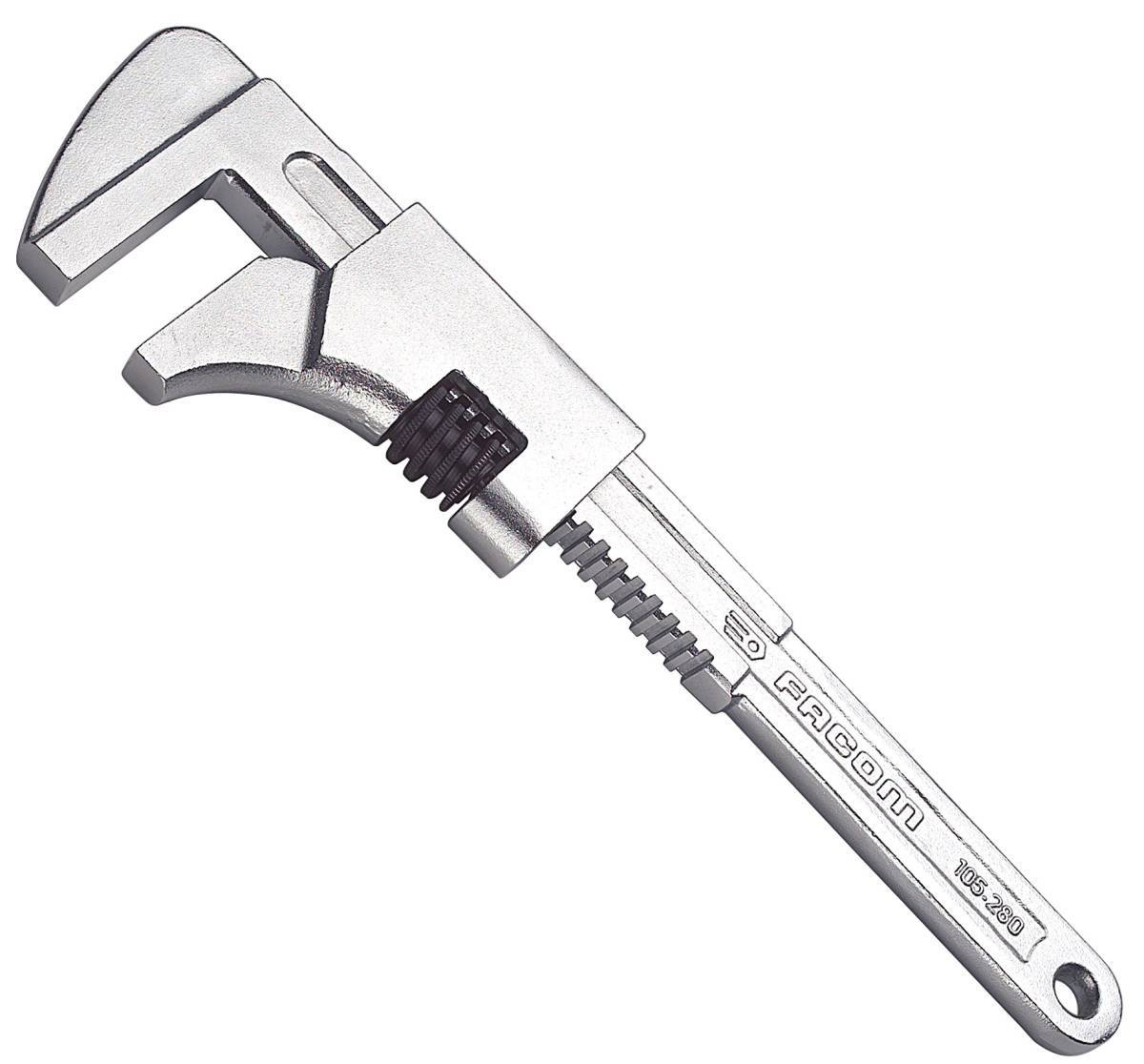

A monkey wrench is a pipe wrench to we hillbillies. Just a harder to spell fancier term. The simpler the better.
Nope. A monkey wrench is smooth on the inside of the jaws whereas a pipe wrench has ridges to grab the pipe tighter when torque is applied! :)
Smooth jaws in this application means less damage to the metal being straightened.
