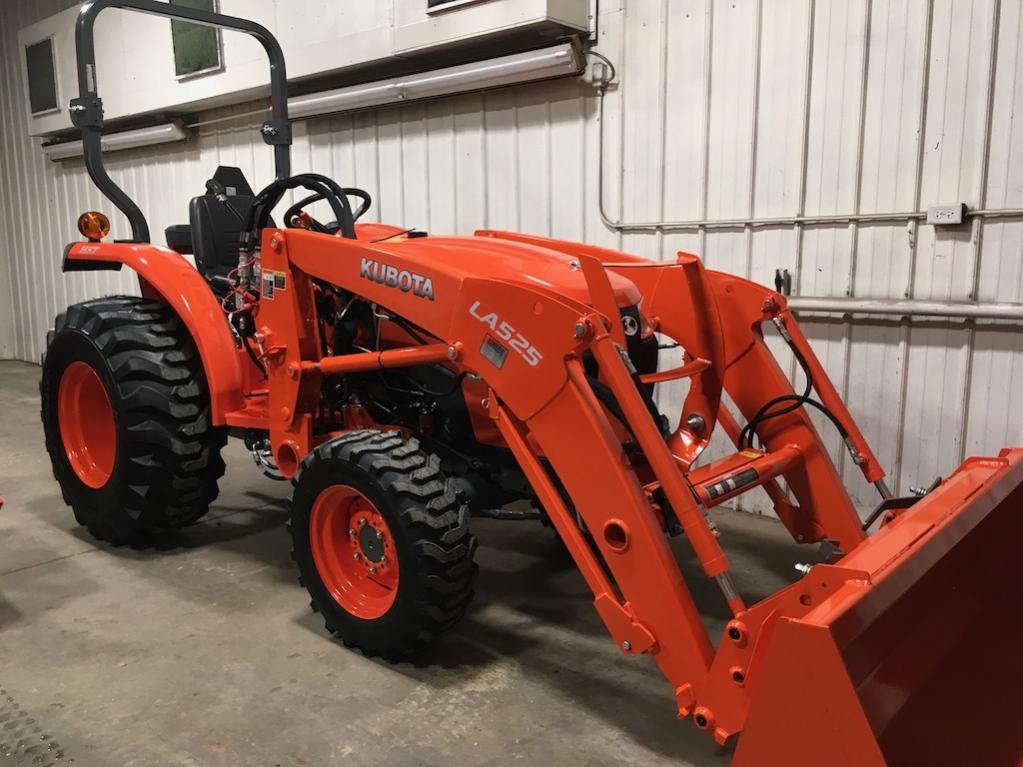

Back from the dealer, inspected and took care of the business end. I should have it at my house in the next few days now.

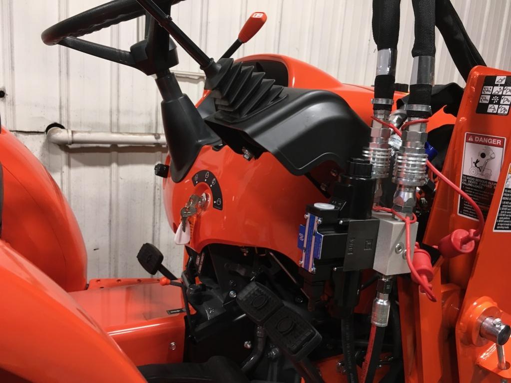

I did spec out the tractor with Landpride dealer installed third function.
I have been looking at a lot of different grapples and will make a decision soon.
I suspect it will never look as nice as it does right now, :eek:

Ken, nice looking rig. But... right there at the dealer is the nicest it's suppose to look.
The reason you bought it is to use it. Some get upset with every imperfection. Just relax and enjoy it. When you get a grapple be sure to add some sort of grill protection before you "need " it.

Ken, great looking tractor. Might I suggest get the dealer to tuck those hydraulic lines up higher beneath the right floor board in your first picture. Also if it has the turnbuckle stabilizers on the three point hitch, talk him into throwing in Telescopic Stabilizer Kit Kubota p/n L8430 LINK TO KIT AT MESSICK'S CLICK HERE.
