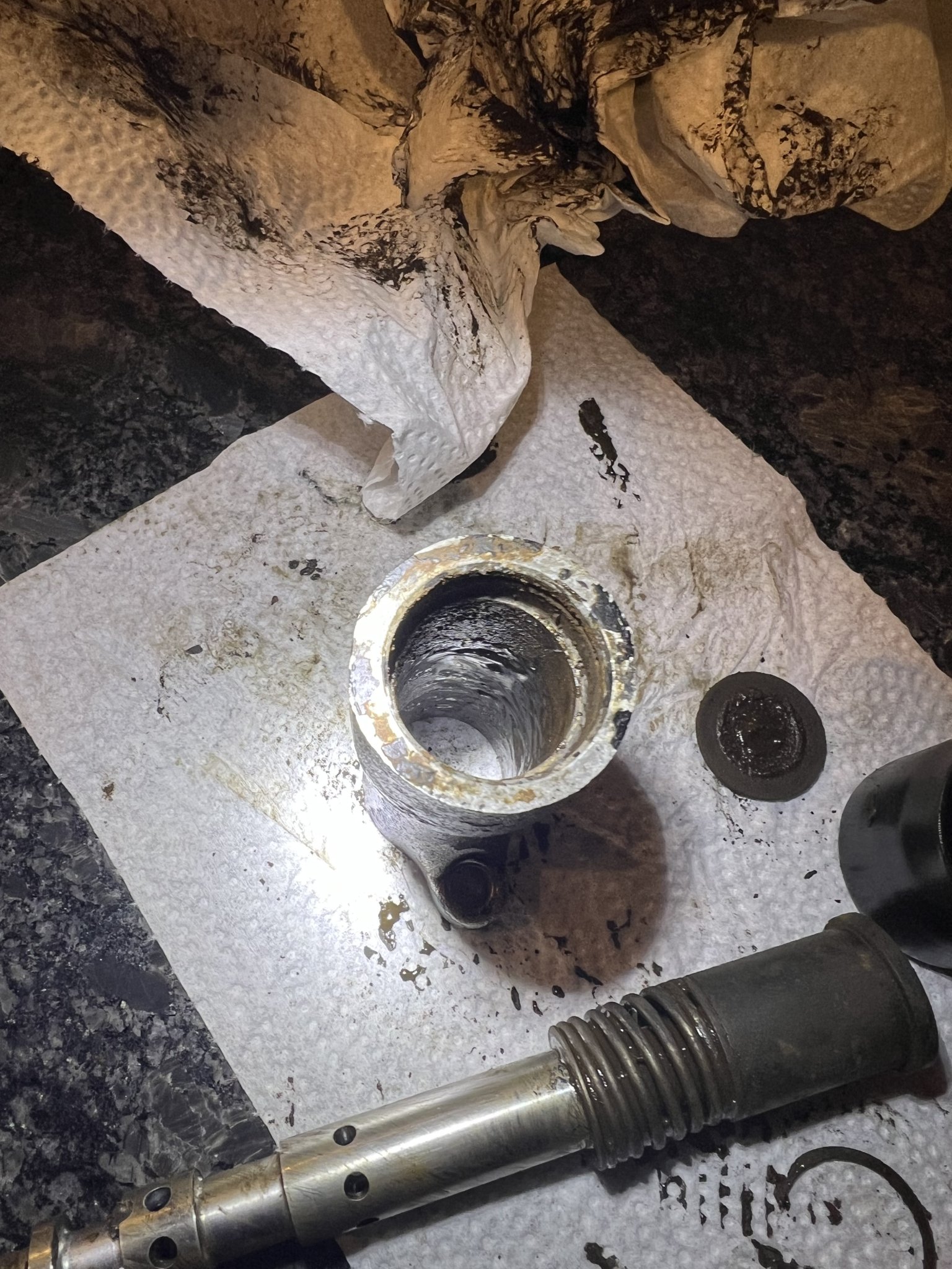

Verified the cable is not broken. When disconnected from the valve, the controls work fine and the cable expands/retracts normally. Removed the spool cap and the entire valve came out (I may be referring incorrectly to specific parts). I had purchased a detent rebuild kit, but don’t see any parts on the removed section that look like what’s in the kit. There was nothing more than what is pictured and nothing fell or dropped out. What am I missing?

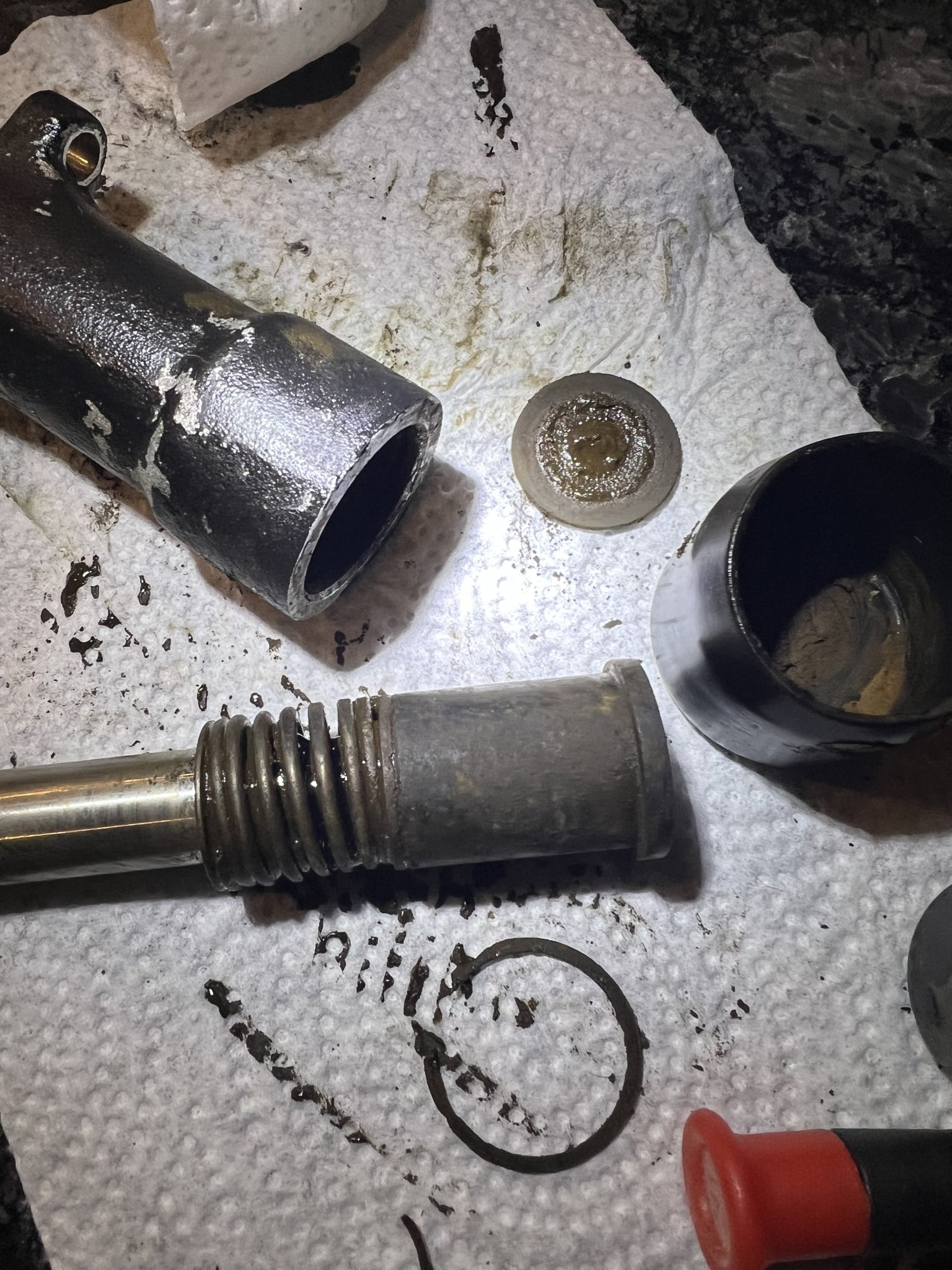

Do me a favor, and take it apart in order so I can see all the parts.

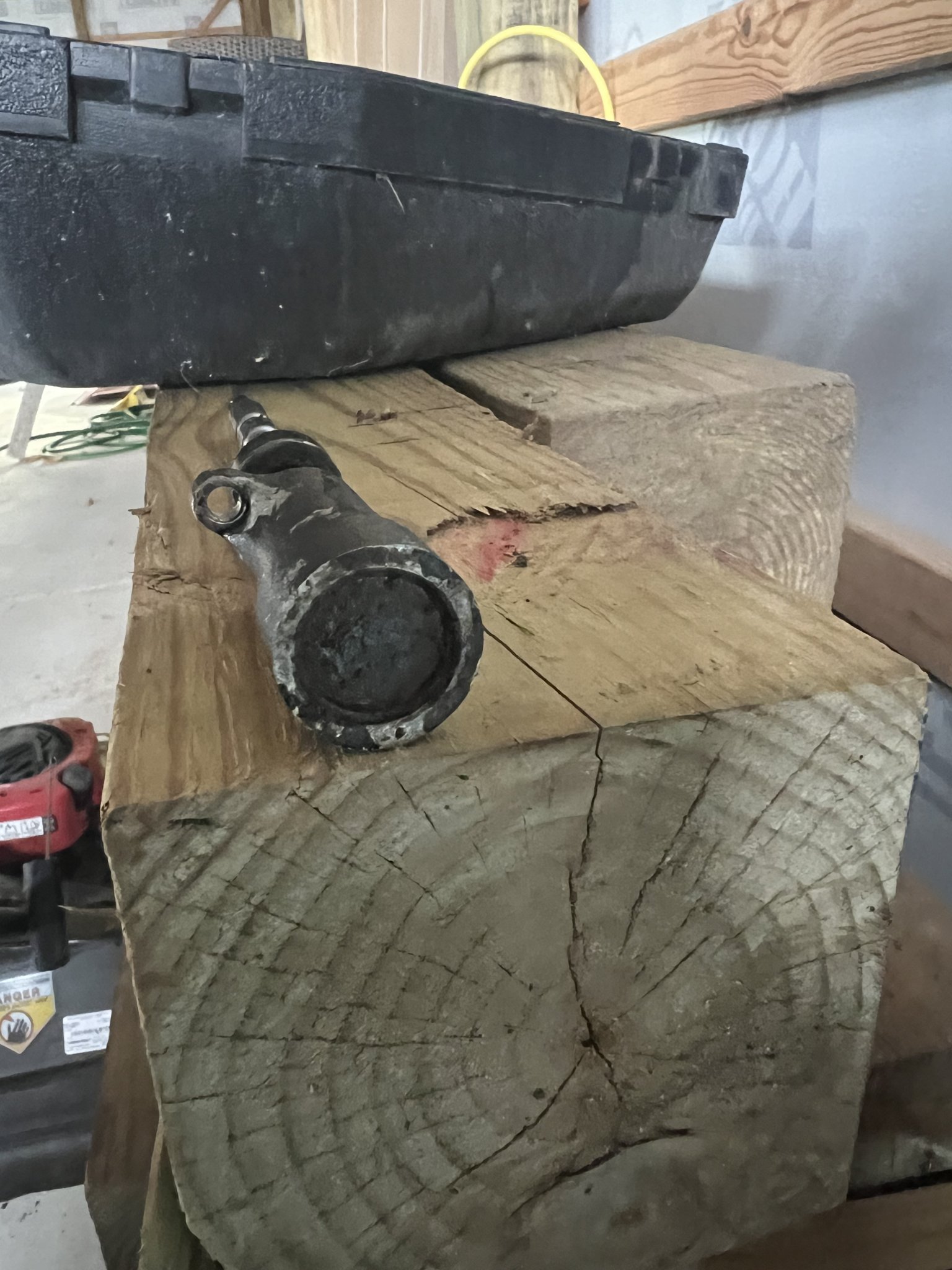

Retaining clip at the end of the spool housing was completely deteriorated. I’ll continue taking apart,

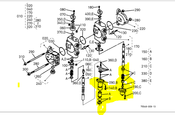

I wanted to update in case it may help someone else with the same issue. It turned out to be the float detent that needed to be rebuilt. I replaced with detent rebuild kit and new spool housing kit. Thanks to everyone who made suggestions, especially North Idaho Wolfman.
