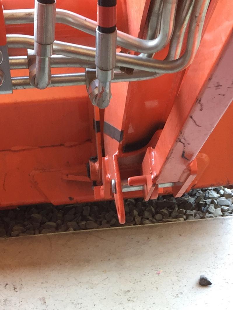

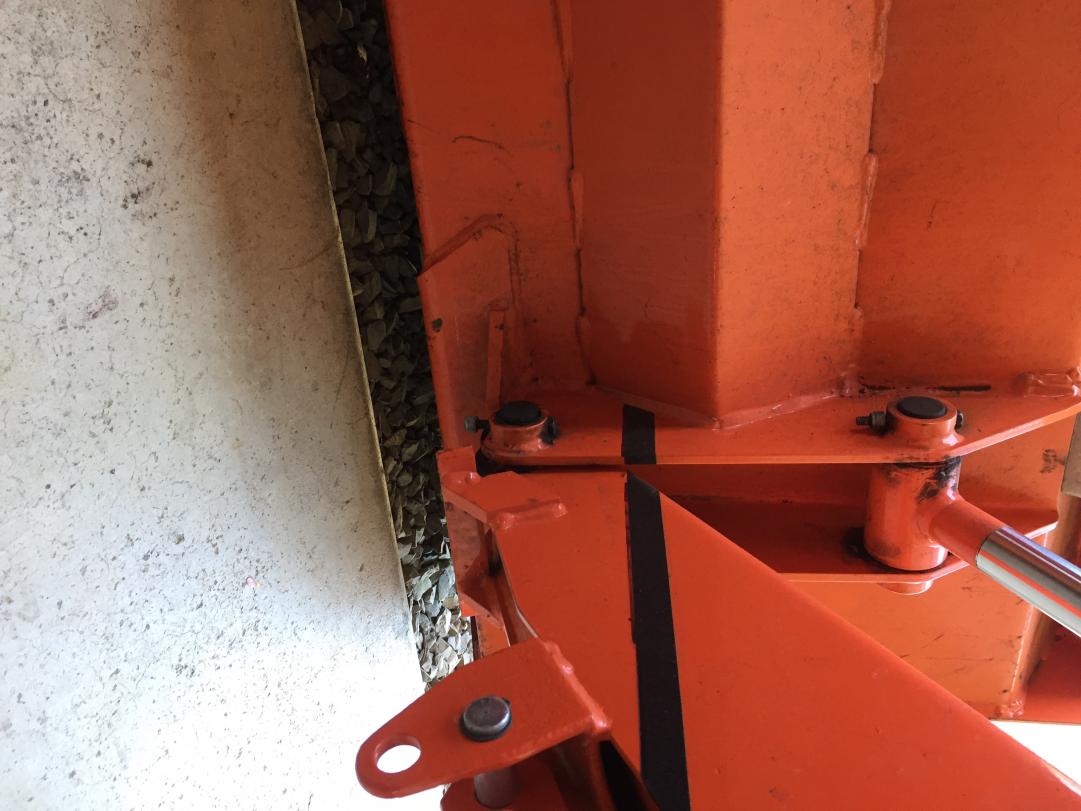

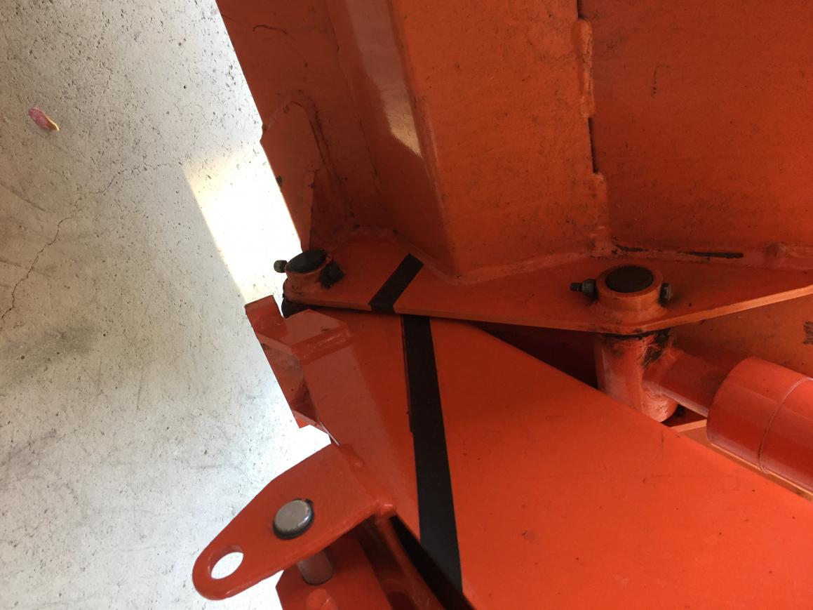

I've been seeing several types of bucket level indicators.
Rods, eyebolts, springs, electronics, etc... Am I missing something?
Electrical tape was my solution to getting my bucket level with the ground and wheels.
first photo-unlevel
second photo- level to ground
third photo- view from tractors seat
sorry, not sure why first two photos are sideways

excellent idea......
However - on the BX series - that spot is almost impossible to see from the seat.
Those that use a telescoping rod seem to have that problem licked.

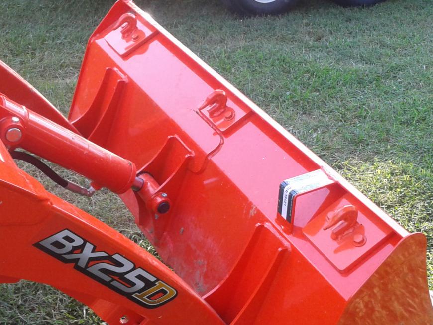

I dont have a real problem with the factory flat spot indicator factory on the bucket! Once you understand after trying and failing .......it becomes clear!:D

I couldnt get the hang of that level indicator sticker on the top of the bucket. Hopefully more time in the seat will help.
11,025
2,897
When we say L E V E L .......
95% of the time, it really is not level - more the fact that the bucket bottom and the plane of the 4 tires are in the same plane!!!
Slight incline up or down......we do NOT want the bucket level .....rather parallel or in the plane of the wheels tangent to the ground!
It will come in time, the more you screw up the better you will get.......trust me ...the screwing up part......I have had MY fair share of the learning curve!:D

I don't think the sticker itself is the level indicator. It's the fact that the top of that angle piece is the level. When thats level, the bucket is level. Once you get your eyes trained to see that position , all will work well.

That level is not always visible and when it is, judging now level it is can be more guess than anything. My project list includes adding a true level indicator from one the many fine ideas on this site.

No, the sticker is NOT the level indicator ......
but it does say LEVEL INDICATOR on it:D
If the sticker wasnt there.....the new tractor owner would not understand what that angle iron was for....shoot they might use it as a pulling hook!!!
The top of the angle iron is parallel to the bottom of the bucket - and using it.....does take a little time to get it right;)
