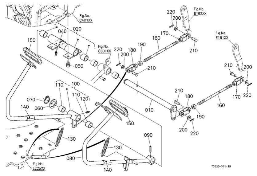

Sorry I didn't get the problem you were having the first time I read your post. Here is a illustration of the parts that work the brakes.
I would look to see if ether of the parts marked 210 have come out and see if part mark 160 is still in place on the left brake.
I'm not sure where else to look.
I'm sorry that you are having problems with your L3301 and hope this helps. The drawing is for a L3301DT, I'm not sure if you have a DT or HST. This information wasn't in your post.

Check to see if the roll pin #90 on the parts breakdown is missing. If it is your pedal is just pivoting on the brake shaft rather than moving the linkage. Greasing your shaft may have contributed to the loss of LH brakes but diddling your switch had no effect on the brake failure at all.
