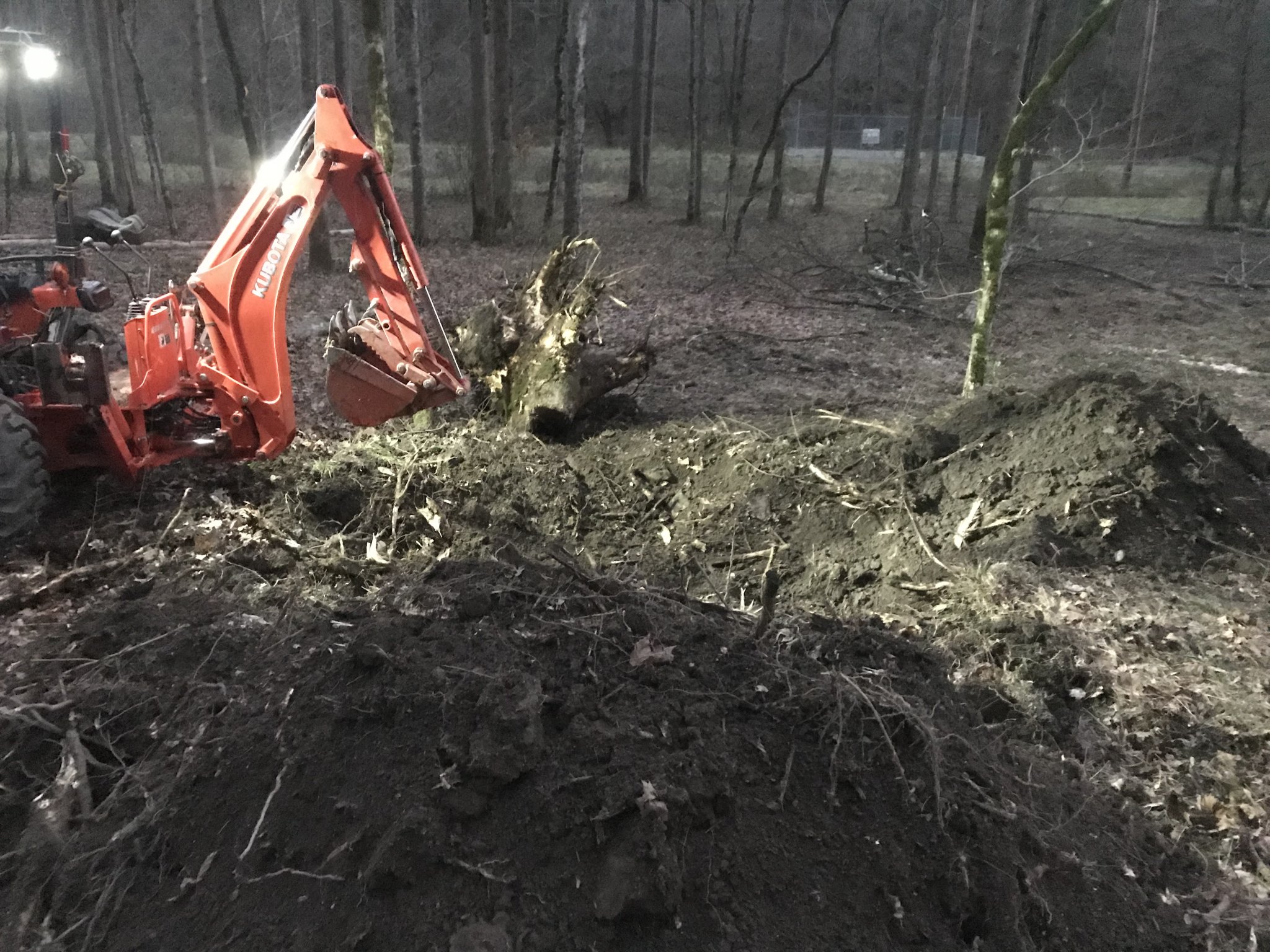

6,673
4,063
As can be seen in the pics in post #9, …because of the wide-area-Glare LEDs make …they will light up the tractor with Glare, instead of the work-area if placed on the ROPS …...therefore I placed an LED lightbar on top of the BrushGuard instead ….
I used square tubing and “J”-bolts …found in the hardware section of TSC.
