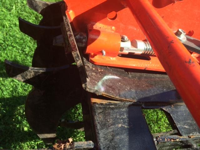

I have just purchased this grapple along with my tractor.. I have 34 hours on the tractor. Of it, about 31 hours with the grapple being used. Im clearing a road thru my property, moving trees, logs, stumps, (not many stumps, but about 4 decent sized ones thus far is all), and rocks/boulders, (some of these being huge,.... On average, the boulders are probably about 3 1/2' to 4' in diameter.... I'd say about 75 of them thus far.
Today I was using the grapple, which is working just fine. But, I noticed the welds look to be ripping/tearing @ the point where the quick attach attaches... I don't have many experiences with welding, except in high school, but it "seems" to me like the welds may not have been deep enough?
Can anyone tell me what the best advice would be to do? Should I contact the dealer? This, understandably, would mean delaying any work I can get done. Or, should I just contact a weld shop and have them repair it? Im not sure if it can be repaired or not, but I sure hope so.

picture1, 2, and 3 are not of much help with out pointing out what/where the damage in the pic is we are to be looking at. Granted someone who knows what it is suppose to look like might be able to pick up on it.
Penetration---- yeah those welds shown in Pics 4 & 5 suck. Look like a pretty weld but no penetration IMHO. Was taking a weld course only a couple years ago. Saw pleny of ugly welds but they had better penetration when we cut them open to inspect than those nice ones do.

Understand what you are saying of first few pictures. Sorry about that. I believe as well the welds are not good. I will have to talk to the dealer and hopefully they will come up with a solution. Thanks again, & as always, I'm still open to more advice or suggestions.

Wouldn't hurt to reweld it. Sounds like the manufacturer concentrated more on pretty instead of good strong welds. Machine/ welding shop would probably do a better job of fixing it. But since it's under warranty, that would be between you and the dealer as far as the fix.

Coach is right, lousy penetration. I'd get much better pictures and use a pencil or other pointer to point to the problem. Can you get the attachment off and tip it over to better show the problem?
I'd then say what your schedule is and put that in writing and then have a welding shop fix it. Looks like that has to be done anyhow.
Your shop may decide to reinforce some bad areas, but picture before and after.

No doubt the welds are not good or at least the ones that I can see from your pictures...cold welds with no penetration...dealer and manufacturer should see the pictures and get something done...Manufacturer needs to see the pictures and offer a replacement. From what I can see it is a manufacturers defect and should be taken care of...I have been welding for 30 years welds may have been pretty but not strong...

Looks like not only cold welds, but not enough-should have been a pass on the underside behind the latch window. Looks like the mount could have been a heavier material.
Nice unit, but looks like a generic QA plate was used.

#1 They used to light of a SSQA plate, they do that to keep the weight down.
Yes the welds are bad, no penetration, but the real reason is the plate thickness is just to light for the amount of force being applied to it.
Get the dealer to fix it, then if it does it again have the SSQA plate cut off of it and put a heavier plate on it! ;)
