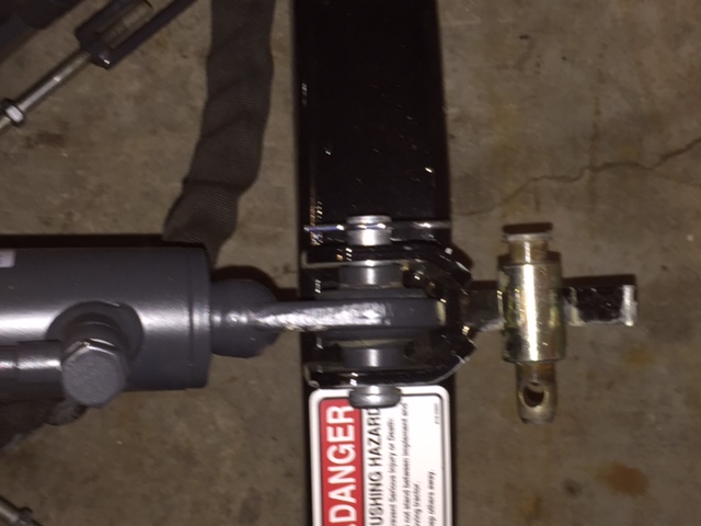

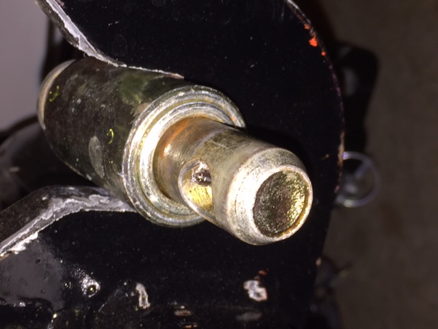

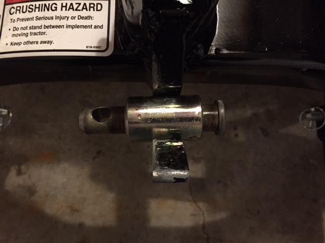

Hi BillK01,
From your earlier post where you stated that the top link was loose, I interpreted your statement to be that the top pin of the rear blade is fitting loose in the big hook on your quick hitch, is this the case? The standard top pin on the blade is 3/4" in diameter, and the big hook will nicely accept a 1 1/4" pin. When using the QH, you need to build up the diameter of the 3/4" pin to 1 1/4" by using the spacers. I have attached some pictures of my set-up to help explain what I have. If your problem is something else, please explain further or provide a picture.
Regards, Rick
Regards, Rick
