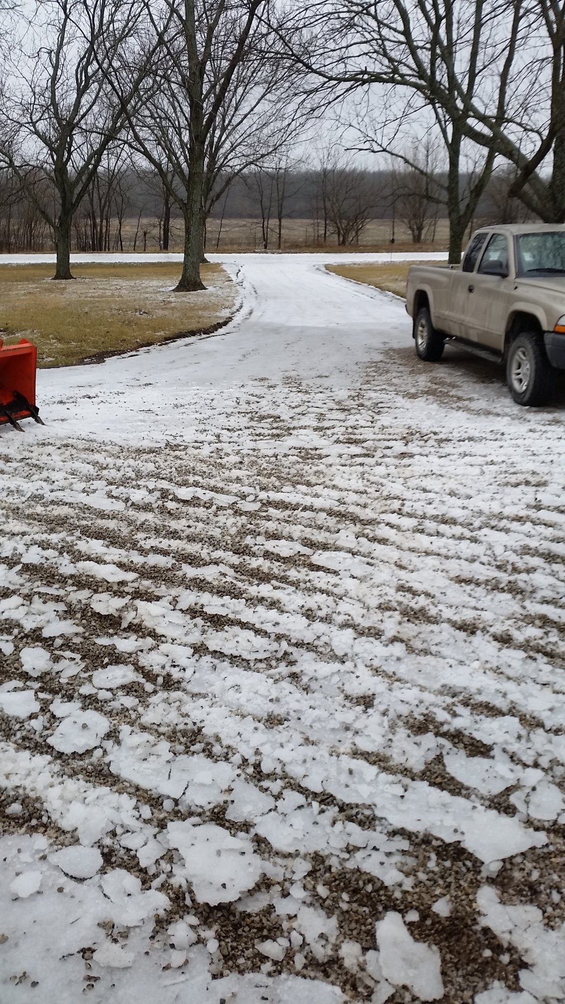

We probably don't has as much area, ice, or freezing temperatures but this is how I solve the problem.
That's cool! (y)

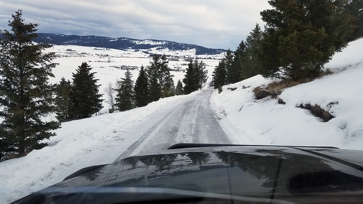

Here are some photos of the driveway taken today.
Heading down.
Heading up.
