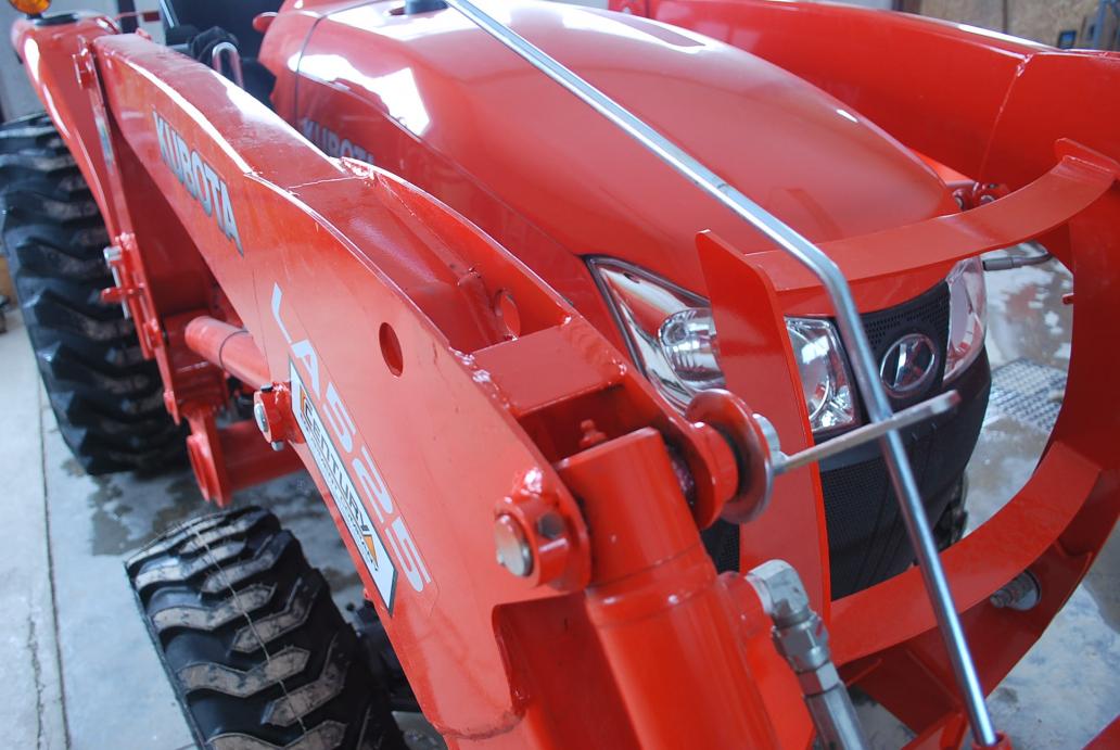

I just purchased a new L3901 w/ LA525 loader. It was delivered Friday and due to poor weather, it was unloaded and driven into my shop. Has .5 hrs on it.
Yep, brackets are already slightly flared out. In fact they are so flimsy, I can move them with my bare hands.
I'll probably just weld in a piece and forget about it.
I've had many Kubota products and never felt they were under engineered. However, I do believe the 3/16 plate on these loaders is too thin.

Can you please add your FEL to the database that I have setup so we can track this? You can find the here. Thanks in advance!
Done.
Mine are actually bent inward slightly. The width of the loader frame is 2.7"
My measurements average 2.509"
I also took a look at my M7040 loader, and the design differs by not only thicker plate, but the distance from the pin to the face of the loader frame is much shorter. I'll try and get some pics uploaded tonight to show everyone.

I started this thread because mine was a problem, and becoming worse. I could see the change from new and watched it getting worse. The brackets had spread so much that the pin was coming out of the bore. Like I had mentioned in one of my earlier posts I regret very much not have taken before pictures. I simply saw the problem and built a solution. Starting this thread was an afterthought and I wish I had considered it before the repair.
I certainly do not blame you for deciding to wait and see if the brackets move. I see no downside to that choice. This problem is simply not a big deal in my opinion, no "Horror Story" here. This situation can very easily be monitored. I have no axe to grind with Kubota and ask nothing of them, (some orange paint perhaps). I love my tractor, loader, backhoe, and would purchase this setup again in a heartbeat:)

Well.....since I already had the correct color "official spray paint", for touching up my loader bucket after welding on 3 grab hooks, AND had the welder out, I went ahead and welded in some 3/16" flat bar between the brackets. It took about 5 minutes per side including grinding off the paint first and cutting the flat bar. I recessed them about 1/4" below the top, making for a real easy to get at weld. Today, I will get the Rustoleum red metal primer out (I love the stuff, two coats and no finish coat is how I do all my metal work usually) and finish it off with the orange rattle can. Probably/maybe not needed but it fell into the category of being so quick and easy to do, why the hell not? I'll post a picture later.
