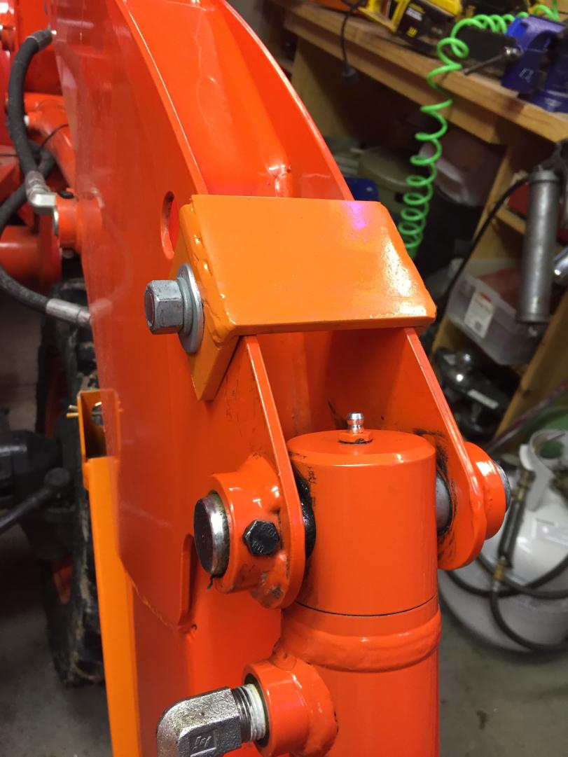

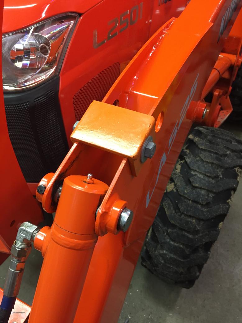

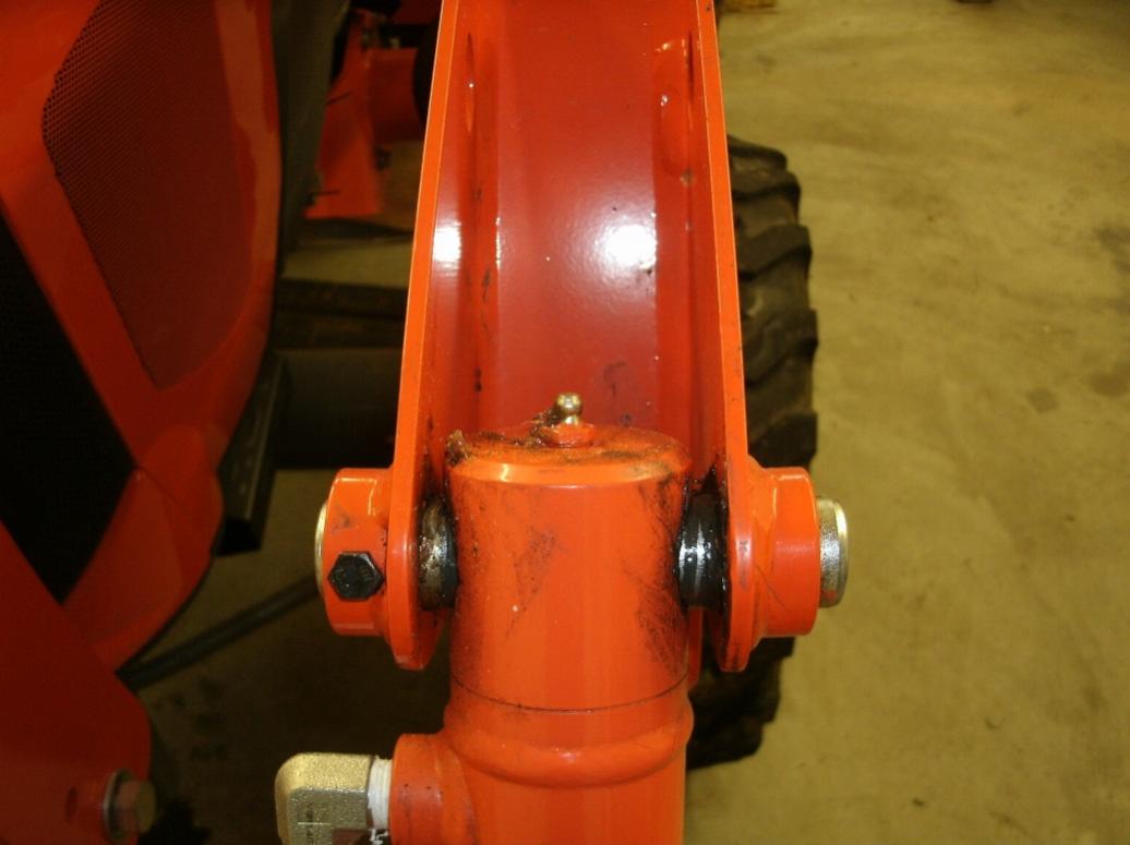

I recently noticed that the brackets on my loader arms where the loader tilt rams attach via pins were starting to widen. It looks to me like the gauge steel used for those brackets is a bit light. My friend has a similar loader and his is doing the same thing.
I carefully examined the rest of the loader and all is well, it was just these brackets. I have always kept the pins lubricated so I do not believe this is a lack of maintenance issue.

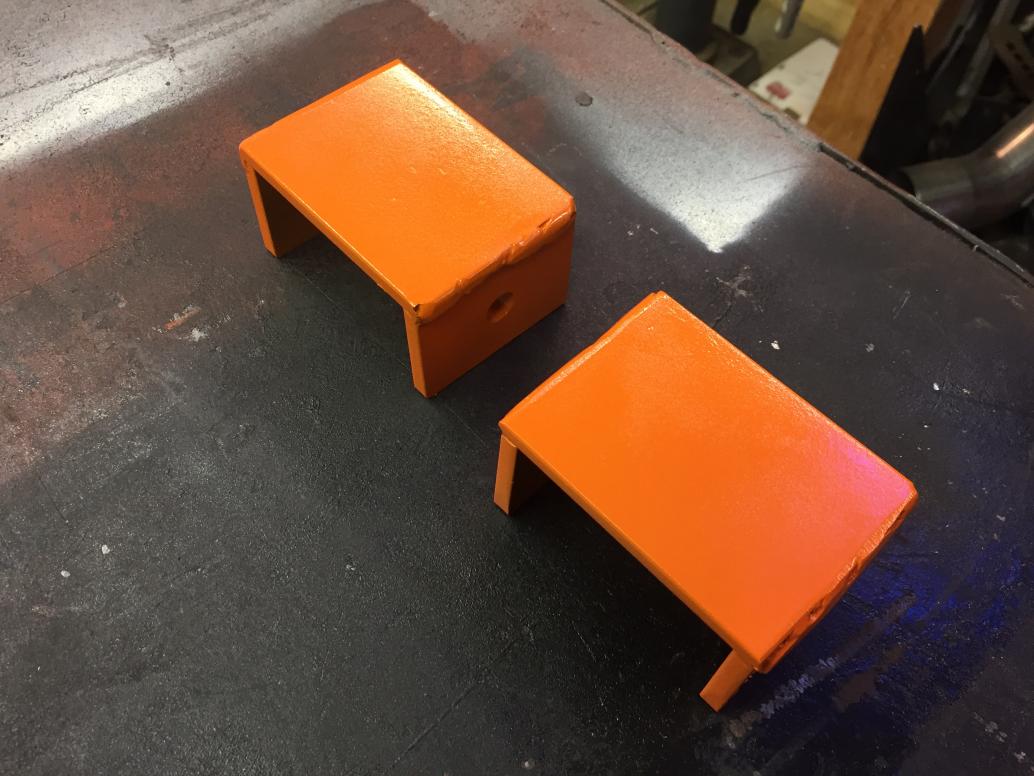

I used a huge "C" Clamp to pull the brackets back into position and made a couple of heavy duty reinforcements pieces to add substantial heft to these brackets. I used 1/2" galvanized bolts to attach them. This did require drilling holes in the factory brackets. I could not bring myself to weld them on, this tractor is not old enough for that
