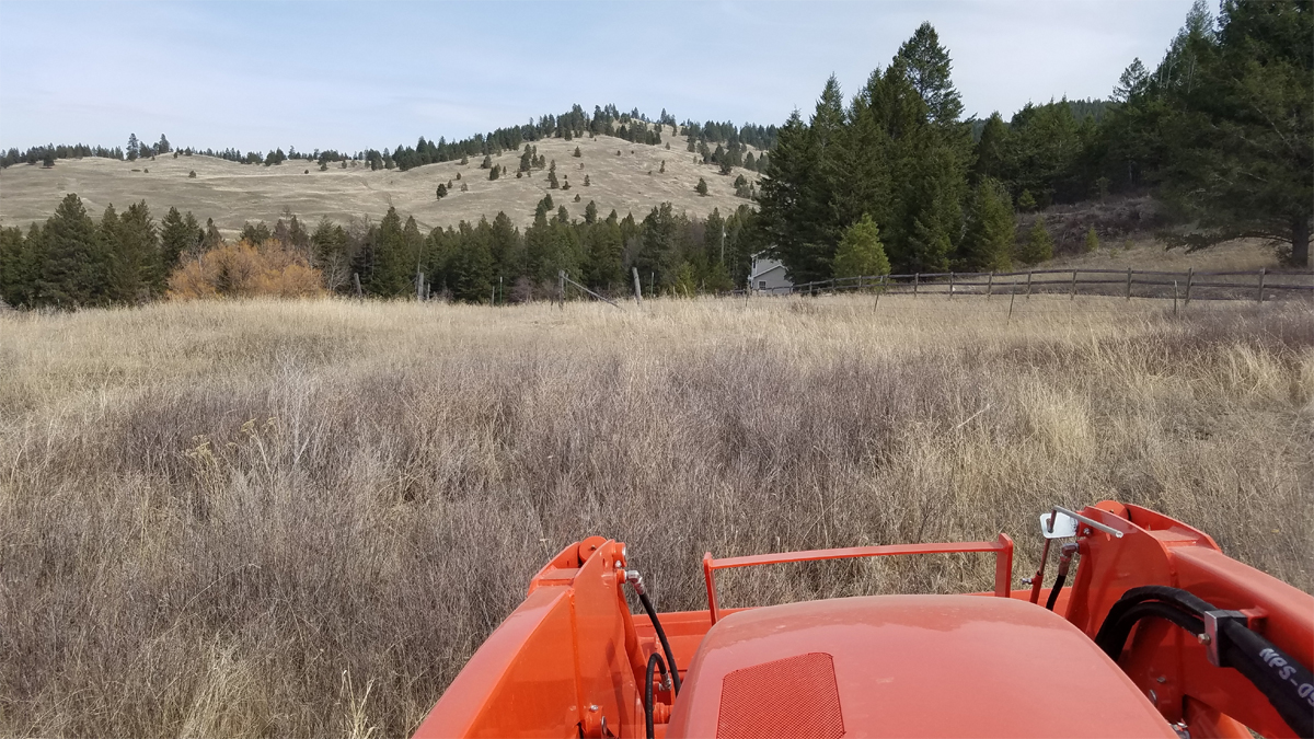

I’m new to Orange Tractor Talks, and I’m looking for some advice on a new purchase. I’m upgrading my B3200 to a larger tractor to take care of 35 acres. About 25 acres of fields for a rotary cutter, a grapple for down tress/limbs and trail maintenance. I need a cab and I am seriously considering an L6060 Grand. Will that machine be able to handle an 1872 rotary cutter okay on property with some hills and slopes? I know it has the necessary PTO horsepower, but is it big and heavy enough to handle a 6 foot cutter behind it going down or up a hill? Any other thoughts regarding the L6060 would be helpful. Thanks
I have an MX6000 HSTC currently, but last year had no problems dragging an RCR1884 around with the MX6000 HST (now sold) cutting 12 or so acres on my property which is very hilly, and about the same acreage at a friend's property which is basically flat. As @SDT said, the type and condition of the vegetation being cut combined with how fast you can or want to cut are important variables.
Neither of the scenarios shown below presented a challenge for the MX6000 and RCR1884.
Start with this ...
And end with this ...
And then there's this ...
