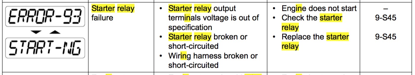

My M59 WSM says ERROR-93 : Starter relay in trouble
I guess I might have snagged a wire or something just long enough to set the code or something but didn't actually damage anything.
a) I have the L47/M59 WSM but I couldn't find that in there anywhere. What section did you find it in?
b) Any idea if I can clear this myself to see if it resets or is that dealer-only?

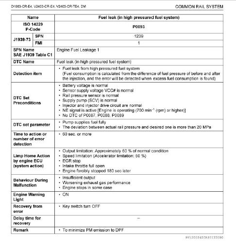

I have the codes for L series if you want them for the next problem :)
Send me a pm with your email and I will send you a link to the file.
I guess, but doesn't 4 in 220 hrs/14 months seem like a bit more often than time-to-time?
With regards to your hose going at the same time it seems to me they are un-related to an electrical issue. What are you doing when you blow the hoses? Last time I blew a hose was on my case 580D the loader boom hose blew while driving on bumpy ground with a fully loaded bucket. Where are the hoses popping, in the middle somewhere? At a sharp radius? Are they rubbing? Failure at or near the crimps? the fittings? Maybe your pressure is set too high, maybe you are overloading something, maybe you got a bad lot number from the hose manufacturer. What year is your machine? Do you store it inside or outside?
For the error code I got mine from Page 9-M21
on 3-S7 it shows
on 3-S7 it shows
Mikester,
If you notice you have noted ERROR-93 not ERROR P0093 2 way different codes.
The M59 is a standard mechanical fuel injection feed engine, with little to no engine computer control and with a simple dash driven computer.
The M47 is a common rail full computer controlled engine with DTC codes (similar to OBD codes).

PO093...fuel system pressure abnormality.
Replace the fuel filter first, and for crying out loud, use a Kubota filter (not some pile of steaming feces aftermarket filter)......there is a BIG difference when it comes to common rail engines with the micron size filtration. Common rail stuff will not tolerate ANY water or dirt in the system as it runs at up to ~26,000 PSI, which requires very close tolerances in the high pressure pump. And....you don't want to know what that pump costs. Or injectors. Keep filters squeaky clean and keep your fuel filtered and as clean as humanly possible.
Could also be an abnormality with the rail pressure sensor but the sensor is not available separate from the fuel rail, last I checked about $1500 + a bunch of labor should you have to pay a dealer. Change the fuel filter FIRST. The spin-on filter. Also clean the separator and it's bowl.
PO093 can also be set if there's a large fuel system leak, which can result from a lot of things, but usually if that's the case, "most" of the time it's visible....and because the fuel system runs at such high pressure, better have skin and face protection when inspecting for a leak in the high pressure side of the system. I seen a leaky injector line on an older M108X one time and if I'd have been near it with no eye protection, would've lost an eye-quick. And I only got one good one so losing that good one would mean I'm totally disabled. While on that subject, it's always adviseable to wear eye protection when working anywhere near these things anyway-as there always seems to be some dirt falling off of something somewhere, and it always seems to fall right into an eye hole. BTDT.

Been busy working on building the house but the P0093 threw again and this time it was accompanied by a P3002 and the engine stopped.
I've checked all over and there's no fuel leaking outside the engine. From carefully rereading the DTC sent to me by you find folks it seems like what that code really means is that the ECU is detecting that it's not burning as much fuel as it should be.
The last time it threw the code it was right after startup so it's not an oil/hydro fluid temp issue. The only thing I found for certain is that it runs fine at lower throttle but if you get up near PTO speed you can feel the HST speed and engine power suddenly drop. (The DTC says power is cut by 50% during code conditions).
It's due for filters so I'm thinking to try a new fuel filter --maybe flow is restricted and it's not getting as much fuel as it actually should be? Other than that, I'm thinking it's time to go off to the dealer for sensor diagnostics.
