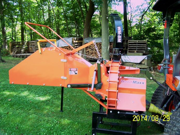

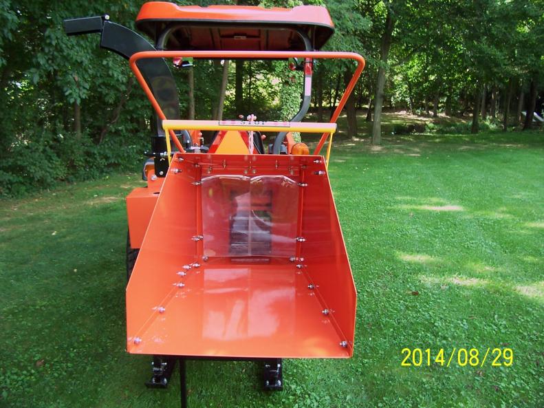

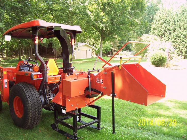

Nice Chipper, I have no complaints. Whatever style PTO, I would engage at the lowest RPM and gradually build to operating speed.
Ron
Will the left pedal on my HST soften the PTO hit, I am still ignorant on this ??
I am planning to buy the WM-8H chipper..... I see you got the mechanical driven single in-feed roller, Is there any reason to want the 8H dual in-feed hydraulic rollers version after using yours or should I just save a few dollars and buy the same one ??? Your feedback would be appreciated. If the 8H is more reliable at drawing in the material it would be worth the diff. when already spending this much, but I am not interested in wasting money. 90% of my work is 1" to 3" and not real branchy. Does that 8m have variable in-feed speed ?? I forgot now....
Doug...
There may be an advantage with the hydraulic feed, but with not seeing one in operation, I can't give a comparison. I do know that my mechanical feed has worked flawlessly with what I've fed it so far. Don't really know if it's worth the extra $$ or not..
