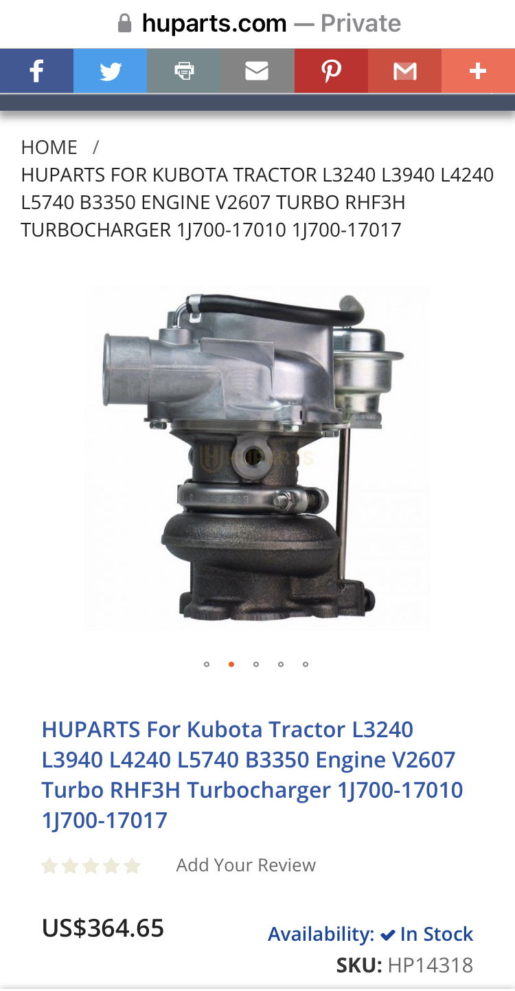

Wondering if anyone has performed a turbo upfit-upgrade on one of these?
I think the boost would come in handy with my front snowblower on my hilly driveway. It is a interim tier 4 without the catalytic converter and dpmf.
