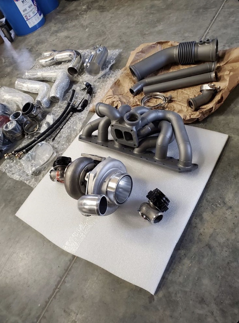

The adaptor between the turbine inlet and the exhaust manifold. I am looking to turbo a v1505 engine and I can swap out to a turbo manifold but then I can only bolt on TD025 (Oh too small) with triangle pattern. Looking to put a TD03 on it but I haven't seen a good way to adapt to the NA exhaust without having the turbo sticking up or out a couple extra inches for the adaptor.
I think the exhaust flange are the same on all the na manifolds like square 2.5" whatever that is metric. Looks like you just made a plate like one would use to convert a T4 turbine to a T3 exhaust. I need that.

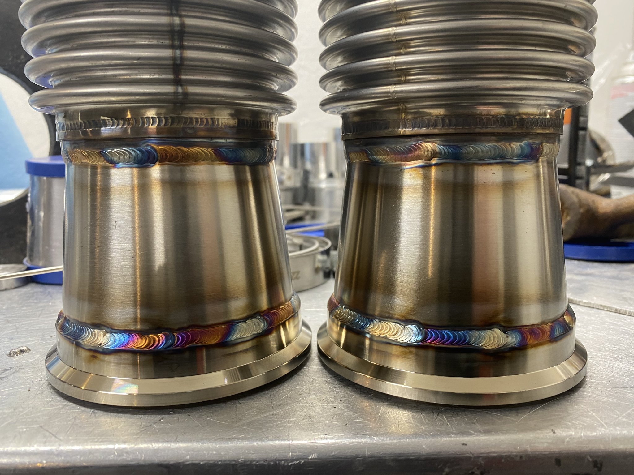

The downpipe would be a great part too from the turbine outlet flange with the conical expansion pipe. Where you welded on your j bend to curve down maybe put a v-band flange? Then anyone could just have a shop fabricate from the v-band to wherever the exhaust wants to go.
Very cool. I was looking at youtube's on some crazy indonesian's or maybe fillipinos that have all turbo'd their kubotas and the things are awesome. There is also the kubota swappers doing turbo kubota's into old jeeps and stuff, so maybe some aftermarket there. They all seem to be working with V2203 base.
Hey man! Attached below are the kits I normally build. It’s mainly a hobby/passion that turned into a business for me but I enjoy fabrication. I currently produce turbo kits for the bmw n54 335i and s55 M platforms check out our website 4NMotorsport.com. This kit on my tractor was pieced together with material I had laying around the shop just for testing. I will absolutely add a 2.5 v band flange and if I decide to sell some I’ll have a full 304ss exhaust included with everything. If you want me to make you a flange for your v1505 to tdo3 turbine housing adapter I can absolutely do that!
